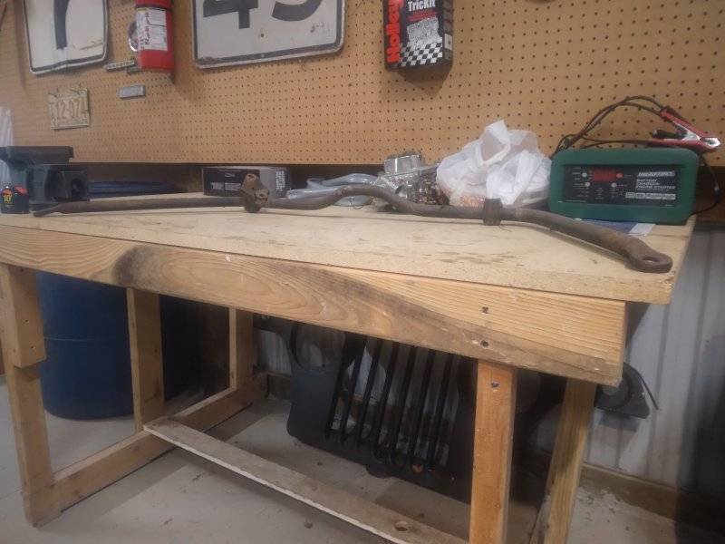

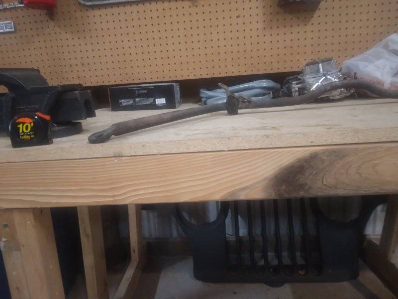

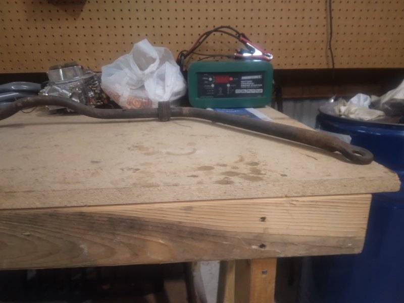

Can you set that rascal up on a fairly level countertop/bench with the ends setting down and take a picture??
Further - would you be willing to sell it/ship it to me?
Here are the pictures you asked for I can check what shipping will cost this weekend and get back to you

was simply to ask if the sway bar could be a contributing factor.
Actually, it doesn't matter anyways if it is or isn't - I know the bar I have needs replaced regardless.
Thanks. :thumbsup:
I’ve been thinking way too much!! Sway bar couldn’t do it unless it’s overloading the the strut rod/lower control arm. It’s nothing but an anti-torque tool to stop body roll. Something in alignment/body is going out of spec while you’re rolling OR “maybe “ a restricted brake line going to rt.frt.??
