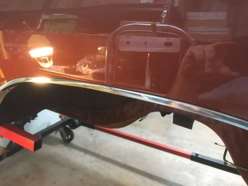

You will be able to do a nice job yourself. I watched those video's also and anything else I could find. The key thing s patience. Certainly don't think your going to a great polish job in a few minutes. Well I guess you could if the trim is in decent shape. One thing I think was mentioned in those vids is Don't be to aggressive. I've had one of my wheel well trim pieces get torn out of my hands. Pushing to hard?? Too much of a angle?? Wasn't holding my tongue the right way?? Many factors. Yes sir! Find a old piece of trim to get the feel of it. It will bend slightly and catch on the wheel. Next thing you know it's bent or flying through the air. So be very careful. Hence the practice piece.
You did mention sanding paper many many grits. I have some up to 3000. But I have never used it. 1800 is as fussy as I seen fit. The compounds do a wonderful job. And yes keep your wheels stored separately. I store mine in big zip lock bags. A different wheel/bag for every color compound. You mentioned a rake. I use a hack saw blade.
Now depending how rough your trim is you will need files. Fine, machinist files. Jeweler files/needle files work nice pick them up at HF also.
As for anvils anything will work . I've used nails/screwdrivers/pieces of steel, aluminum, hard wood. Even rags. That little anvil you listed is nice.
Once more patience. Can't stress that enough.
Here's a few pictures of a wheel well trim I have 8 hours in. Including a trip to a welding shop for a little tig action.
Thanks for the file suggestions. I had seen those used and mentioned in the video but was still researching as to which files would be needed and how aggressive to fine I needed to get.
Wow took me a bit to find those pictures lol
But goes to show you what you can do if your not in a hurry.

Well it all depends right? If your into something like I showed filing down some weld a fairly aggressive file will work for a few strokes. Then work your way down then change up to the paper or emery cloth. Now to take out a dimple you made trying to remove a dent a small finer file for starters then to the courser paper to the finer to remove the scratches and finish off with compounds. Stainless is very forgiving, but keep your dimples small and don't file to much or you will be off to a welding shop near you. lol Make sure if you do need to weld up a crack or hole, get yourself a good welder who knows what he or she is doing. You have heard the of guys that can weld razor blades or pop cans? Those are the people you need. This stuff is thinnnn.
Once more give it a try on a scrap piece of trim. A little dent and scratches are easy. Now once the dent is behind a crease now your in for some fun.
