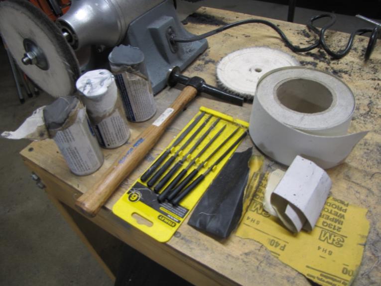

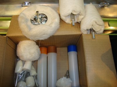

Wow.......That's insane! $75 Bucks on a table buffer, $30 on a buffing kit (including wheels and compound from Eastwood), some sand paper (120, 220, 400), precision files and a body hammer..........you just saved a ton of money. Rechroming obviously needs to be sourced out, but for the stainless and aluminum, do it yourself. You can by anodizing kits.
Honestly it's not that hard to do and the reason it's so pricey is that it's very time consuming. I do all my own and taught myself. Watched some video's, asked some questions and practiced on some old trim out of the boneyard. Get good at it, the aluminum will look new and your stainless will look like chrome. I feel for you guys. That's a heck of an extra expense for bright work.

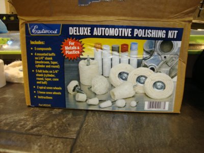

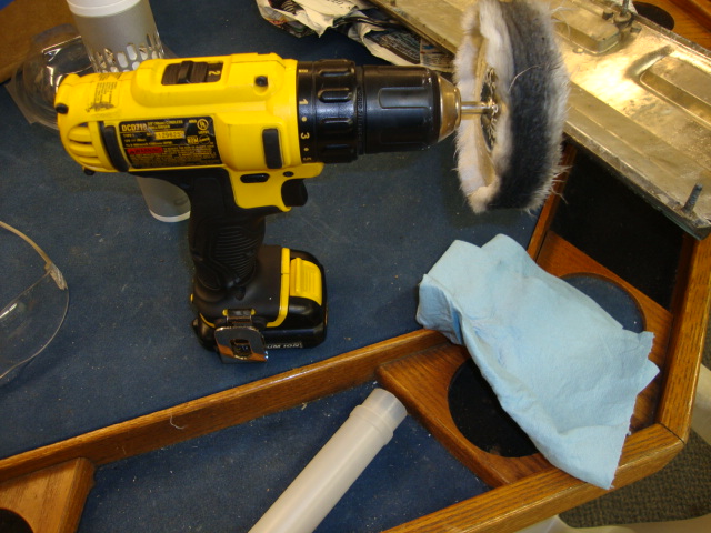

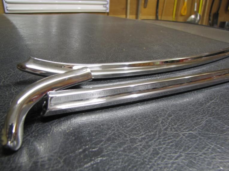

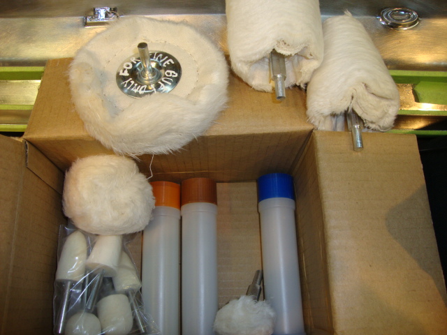

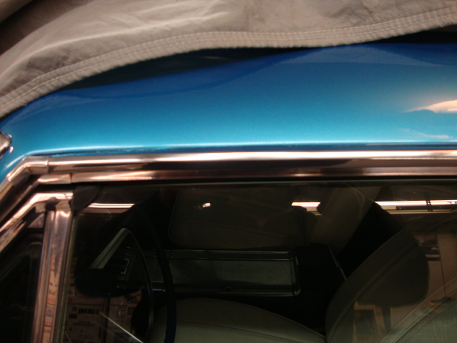

truth be told, im buffing the stainless on da olde GTXer as we speak (still on the car). it's my first time, and it's coming out great. i purchased the "deluxe" eastwood buffing kit, i have my little dewalt drill and im going to town.
it is time consuming, but its actually pretty fun.
looked like carp before and now it looks like bass. lol

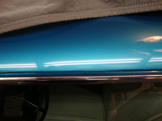

a few pics..prob can't tell, but it does look a helluva better than it did.
