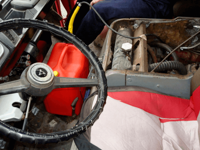

What are you worried about? I drove around like this for a while. :lol:
(Warning: Do not try this at home.)
