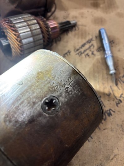

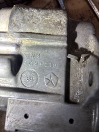

The star wheel on the side of the aluminum housing has a 68 in the center, which is good for a 69 car. The bad news is that the 3 digit number on the barrel is 30:. I’m guessing that means 3rd week of 1970 but I’m wondering what the colon after the 30 means? I can’t recall seeing a colon after a date number before.
What is the entire number – all of the digits – on the motor housing ("barrel")?
Post a pic of it as well to help with the decoding
This starter is not original to the car.
2095 219 is the pinion housing for the pre-1970 starter (brush plate attached to pinion housing with one internal screw). It was used on two starter motor assemblies (that's the number on the round motor housing): 2095 150, used '62 to '69, and 2098 500, used '63-'69.
2875 560 was the first of the revised-design starters, introduced for the 1970 model year (though some late-production '69s got the new starter, too, per a TSB). The pinion housing is 2875 551, and the brush plate attaches to it with two external screws threading into ears that weren't present on the earlier pinion housing. This design was kept through to the 1987 end of the Chrysler-built gear-reduction starter, though in '74 there was a part number change on the pinion housing from 2875 551 to 3755 261.
So: no, this is not the car's original starter. It's a "reman" unit thrown together from mixmatched parts. Probably doesn't have the original-type field coils in it, either (original would've been 3-series/1-shunt, versus the later 4-series, which the "remanufacturers" tended to throw in all the starters).
The original starter on your car would have been a 2095 150 or 2875 560 with a build date zero to a few months before the car's build date.
