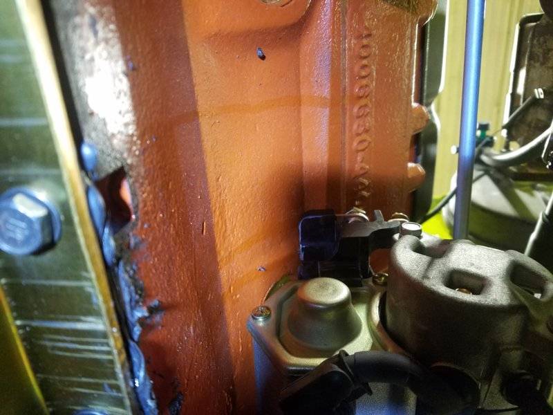

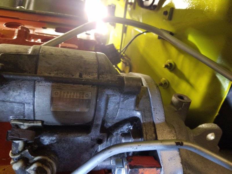

What do you guys use for starters?
This is one I bought from a parts store and it won't even bolt onto the motor securely do to clearance issues. It wants to hit the block up high and won't draw in on the front
Engine is a 440, probably came from a motor home originally.
Looks like you need the terminal relocators, from the pic, best I can see.

I believe mine was from an 80s Ram? Seams to me I had to modify the insulated strap they put on them to gain clearance or just wire it without... can't remember but it fit afterwards. Even the mini starters are pretty much a copy of that same setup and are a snug fit do to where the terminals are located.
The starters going back to Napa.
I like 747Mopars idea. I have several parts Dakotas and I think one of them may work.
Worth a try anyway
I had a similar problem years ago with putting a dakota starter in my 383.
Just grind off the problem area on the starter.
I think my wiring connections were OK though. You might want to try a starter from a Dakota.
I use a Dakota starter, I think its for a 95, but its worked great, only thing I had to do was to remove the terminal extender block because of clearance issues, and it was good, no fitment issues, but this is also on a 340.
I had this on mine. I also removed the plastic black piece. Also it's easier if you can hook up the wiring before installing the starter.

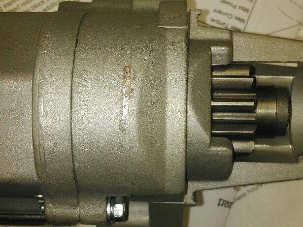

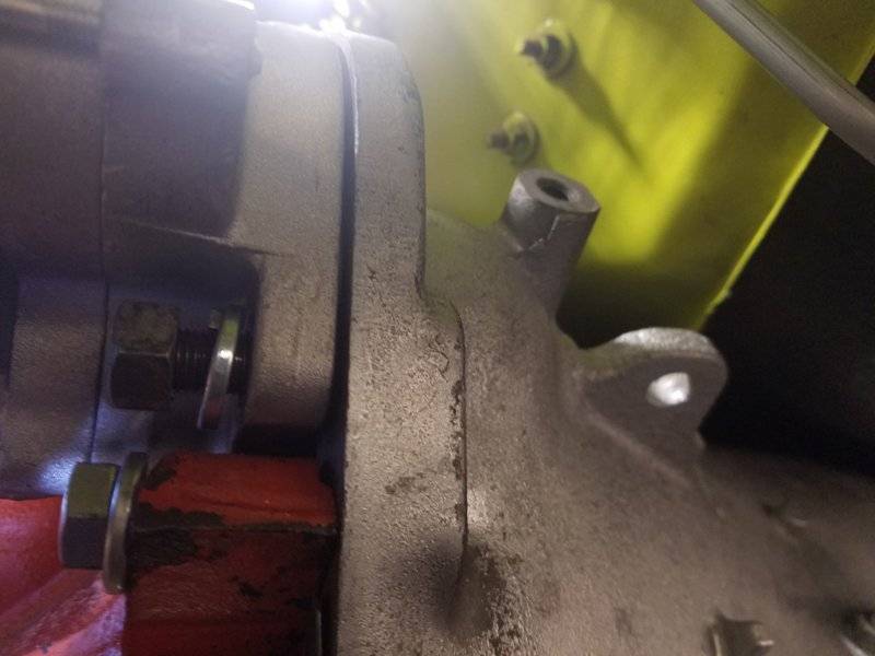

So spent a little time over the weekend on the car. Lots of work and little progress! First the mini starter I got didn't want to pull down flush on the tranny. After some looking with the flash light I found this!
See the raised boss there with the smudge on it, yep had to remove it, was rubbing on the block. I removed that and got almost there. I had to take .020 off the snout pilot then she went in like it was supposed to. Next up kick down linkage.

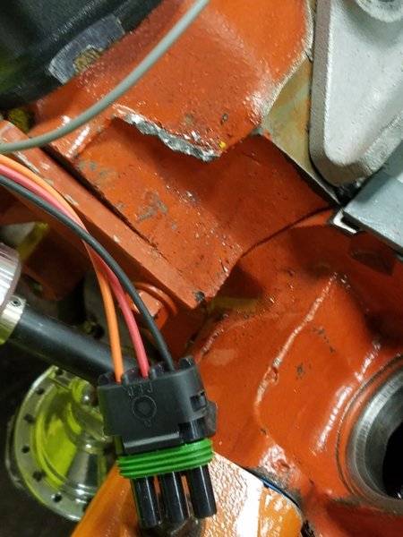

I also had to clearance the block. There was some casting flash keepin the starter from sitting flush.
I don't see any of that on my block.
I think it's just the location of the terminals

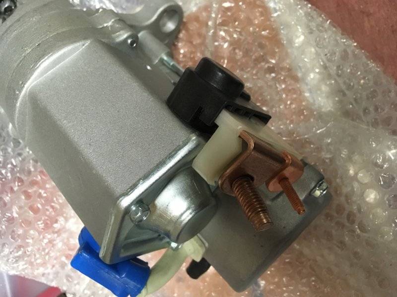

Beekool, here’s my DB with ‘mike67’s’ above post about the terminal kit. Haven’t put it on yet. Maybe it’ll help. Jeff

I found this Chrysler starter. I think I may have it overhauled at a starter shop.
It has no clearance issues.
It was from one of my Dakotas.
Well there ya have it, as I mentioned, Dakota starter less the terminal extension block for the win!!! Looks like the one I am using minus the Chrysler plate and I have about the same amount of clearance on my 340.
