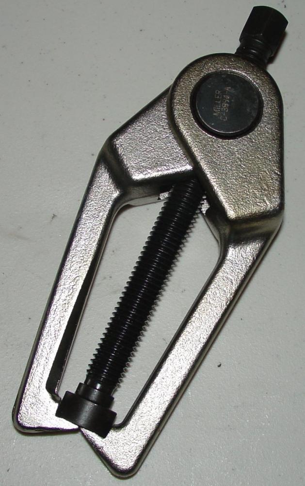

So here is what I have got done so far. Headers loose but not removed.Starter unbolted but not out. The headers are a big problem here not sure how they actually got them in here yet I am sure Headman made them. It looks like I need to drop the steering arm at the front wheels going from side to side tie rod? to let the headers drop down so I can remove the starter. Here is my question the steering arm has two bolts each side and are some kind of ball joint that is pressed in. How do I drop that arm????? Answers greatly appreicated.
If it's the drag link you're referencing, you'll need a tie rod puller.

Nice tool I will look for one. I cant jack the motor since the scatter schield is so close to the floor. I hope the mini starter fits in easier. thanks for the input.
