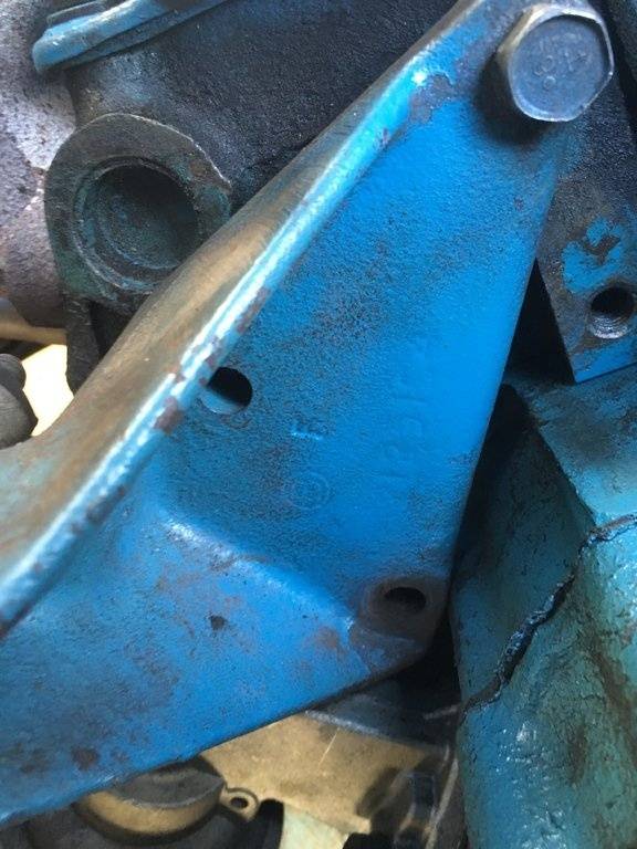

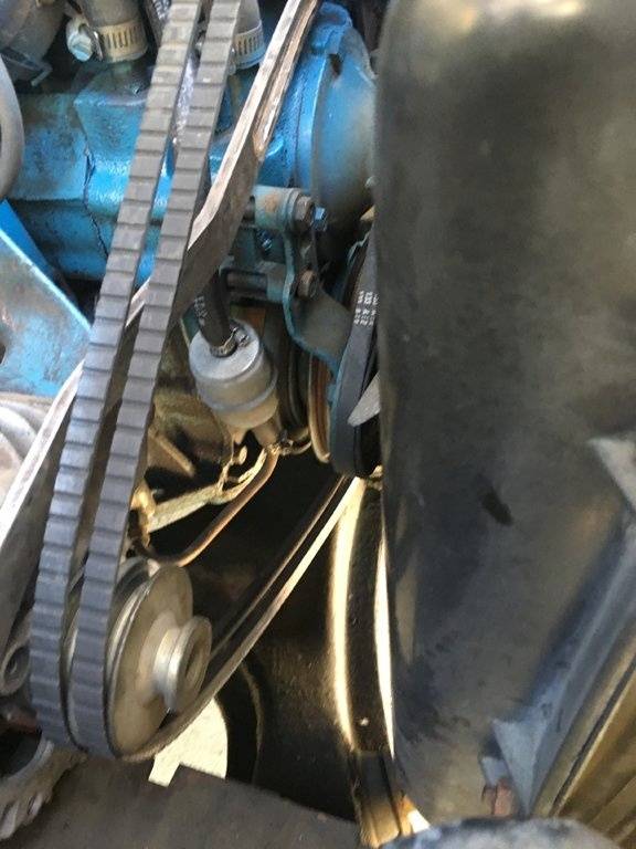

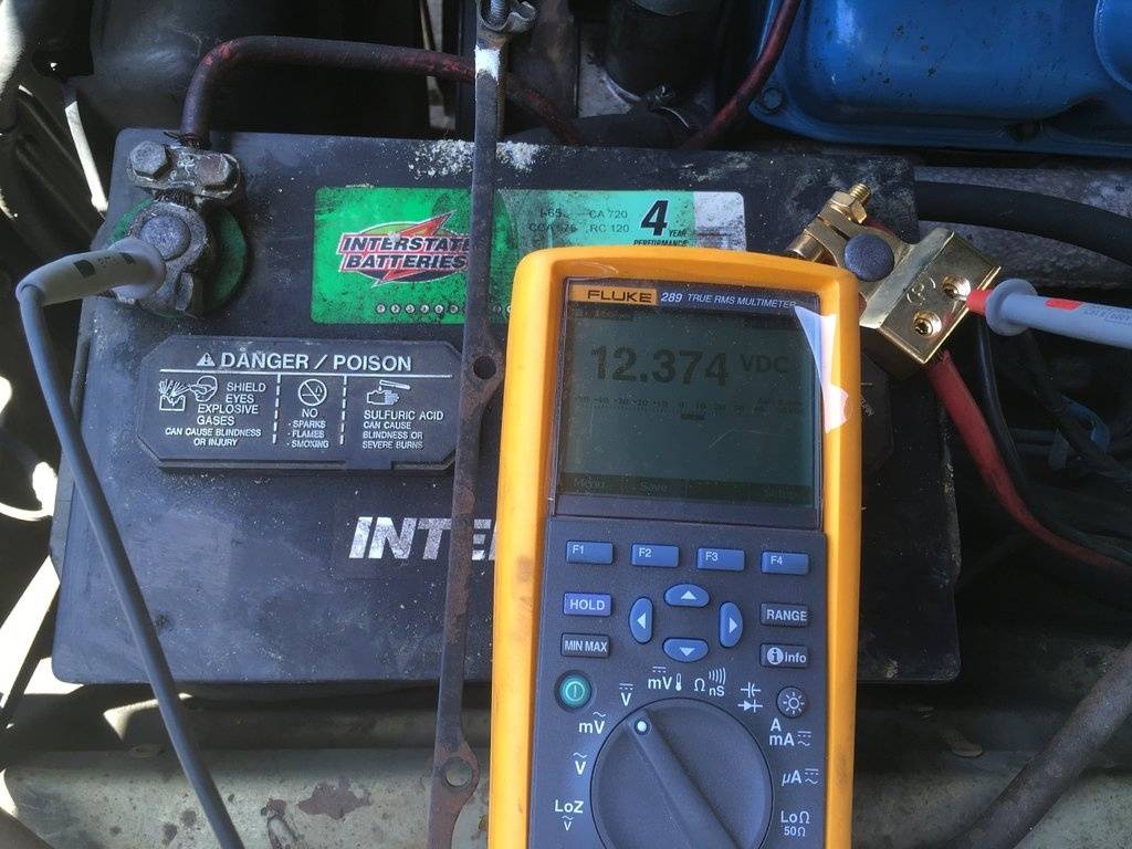

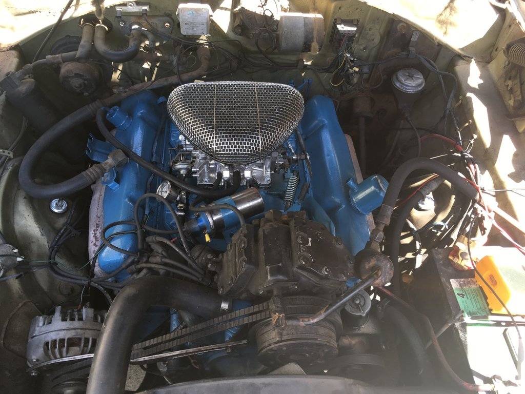

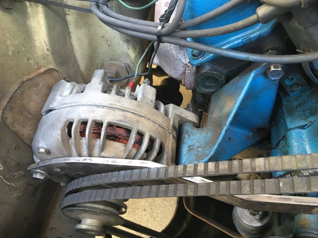

I left my coronet parked for about two weeks while out camping, came home last night tried to move it out of my driveway and it stuttered a bit then click click click. I'm hoping from the video I've posted here someone can give me some pointers where to start. I recently replaced the starter relay, the battery is good and fully charged. I also found out while inspecting everything that the alternator mount is incorrect and the mounting bolt was stripped, they threw a fix a spring thread in and called it a day well that didn't work. I have ordered the correct mounting bracket and it should be here in the morning. Any suggestions would be awesome.

I think your good battery is dead (maybe a small short "somewhere" in the wiring draining it). Jump start it & see if she fires up. Then put a regular old voltage meter on the battery posts. Should be "I think" about 12.2 volts when not running & something like 14.5 volts when running if the alternator is good. Maybe the alternator wasn't charging like you thought if the belt was a little loose? Good place to start anyway.
Thanks, as I mentioned battery is good.

Also you could probably see 12.3v on a meter but have a bad battery(shorted cell). Try a jump start like previously said.

Also a dmm won't show a true state of the battery but can give you a clue . You need a load check to really know its condition
