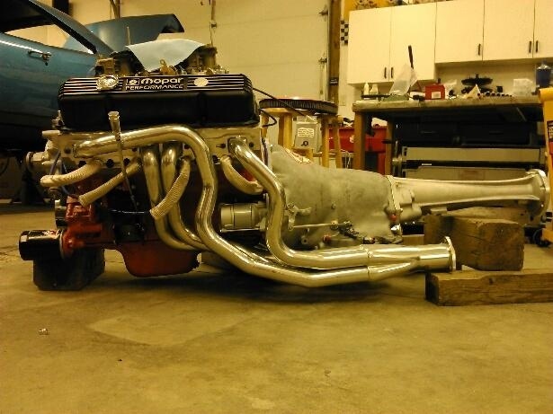

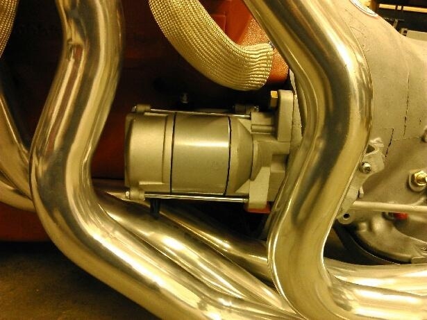

FYI my TTI headers allow me to install the mini starter with out removing them.
Yea, Went with hookers because I didn't have the money for TTI and the rest of the exhaust on the car was already set up for the old hookers that were in it.
Nope, check my thread 69 GTX I have a picture there.
