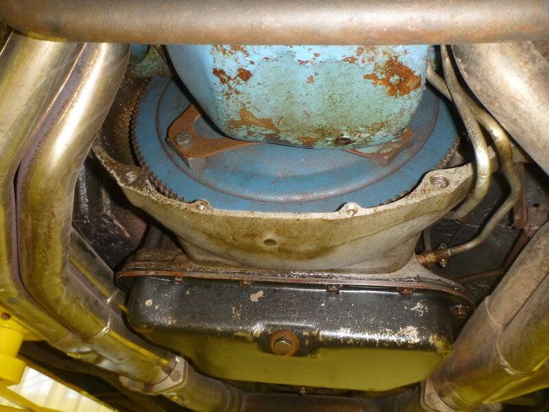

Well if your installer was lazy like the guy that did the Dart I just bought, you've got a wide open window to spray that bendix with some lube...
I will try to lube up and free up the bendix with the starter installed because I have a window like dadsbee shows above. Glad I got on here to get everyone's advice. Thanks 91r/t, Don Frelier and dadsbe for the input and EVERYONE for the welcome! By the way, I'm pretty new to this, got the car about a year ago (previous owner put the big block in it about 6 years ago) but I'm definitely hooked on making this thing run right.
