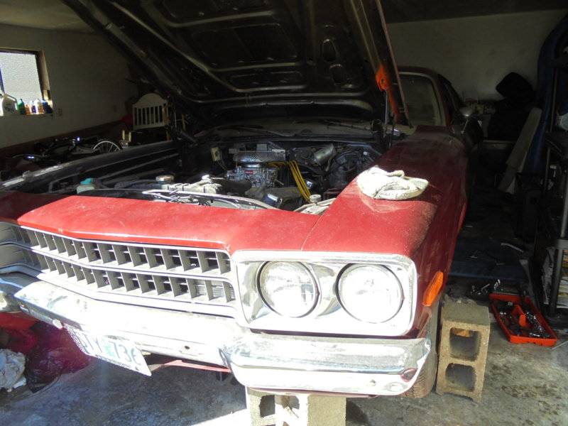

Starting car after 14 years.
levicah
12:07 AM
Mar 16, 2018
104
15
Shelton, WA
STATUS : 74' satellite, 1k miles on a rebuilt 318 w/ 727. 5 gal's of gas in the tank with whole bottle of fuel stabilizer. with car running, fuel stabilizer was sprayed into the carb until the engine stalled. It has been dry and on blocks for 14 years. It ran great but trans dumped fluid. I'm rebuilding the trans now.
I'm about to fire it up: Aside from basic contact cleaning, plugs,dist., etc.
Should I pull the gas tank, or just syphon out old fuel? Just fill it up? Is the carb guaranteed to be gummed up by now?
Is there any "must do" things to insure a successful start up? Any tips would be appreciated!
Also, any tips on removing and installing the front seal on the 727 trans? I dont have a seal tool. Do I just dig the old one out? Is it like a bushing? Thanks guys!

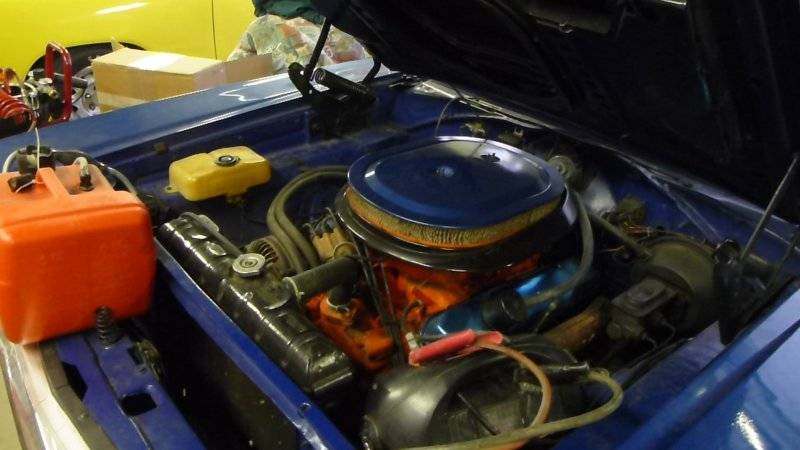

Pull the fuel hose off the pump and replace it with a kicker can if you're in a hurry. Other than that, no point in playing with anything if it ran before storage. Pull the coil wire, crank 'till you have oil pressure, replace the wire, crank and listen to the old music you enjoyed in the past! (and looking at that picture I can't believe I use to think my engine compartment looked good 2 years ago!) My car was stored, this round, for about 14 years. I didn't even do my usual of smothering it out by pouring tranny fluid down the carb when I put it away as I expected it was short term. It's been stored numerous times, for many years, since 1969 and always just had a battery thrown in and started. On old fuel back when.. something you can't do with todays crap.
