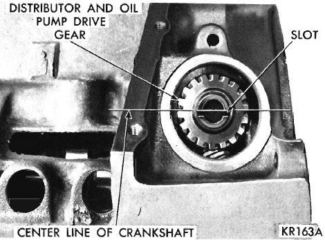

Here is some info from your Service Manual. You can just look it up.
  • 383-440 DISTRIBUTOR OIL PUMP DRIVE INSTALL (1).pdf
