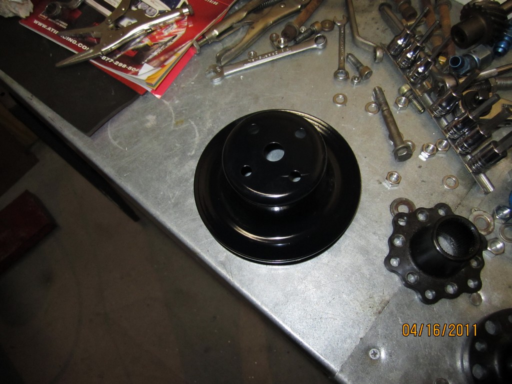

I will try aluminum cleaner 1st,if that is not up to my satisfaction,then it will go in the beadblast cabinet with the pulley.No paint on the waterpump,just the w/p pulley:tongue8:

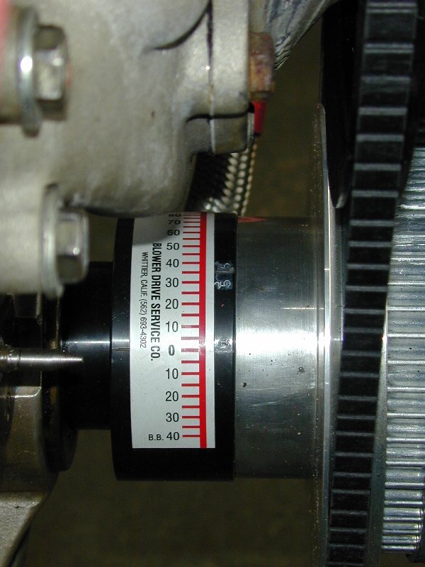

Looking back at my previous posts,I want to clarify something no one noticed or said anything.The BDS crank hub that came with the blower package was a 4 inch and had a 1 inch spacer.When I broke a keyway and spun that hub,the new one was only 3.5 inches and arrived overnight on a friday afternoon the day before the big Englishtown MOPAR weekend.Could not get a 1/2 inch spacer 'till the following week sooooooooooooooo,the car did not make it out that weekend:puke:I called BDS and they said that the 3.5 hub is the only one they been making for 10 years:confused2::shruggy:When i told them I bought the whole kit from them 2 years prior,they had nothing to say.They sold me the older stock.More on that later.

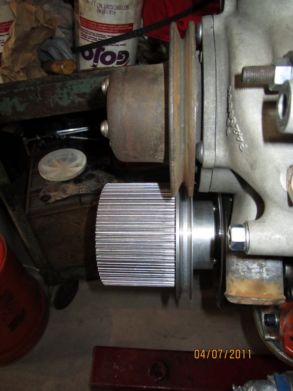

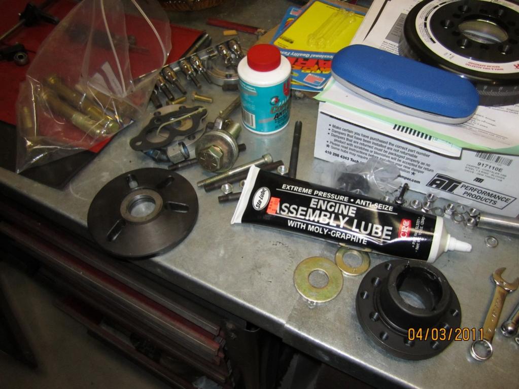

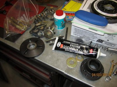

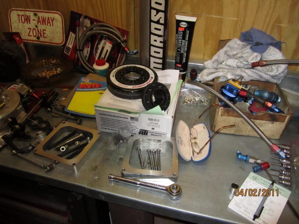

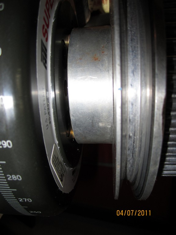

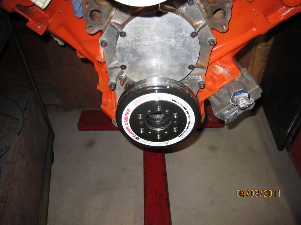

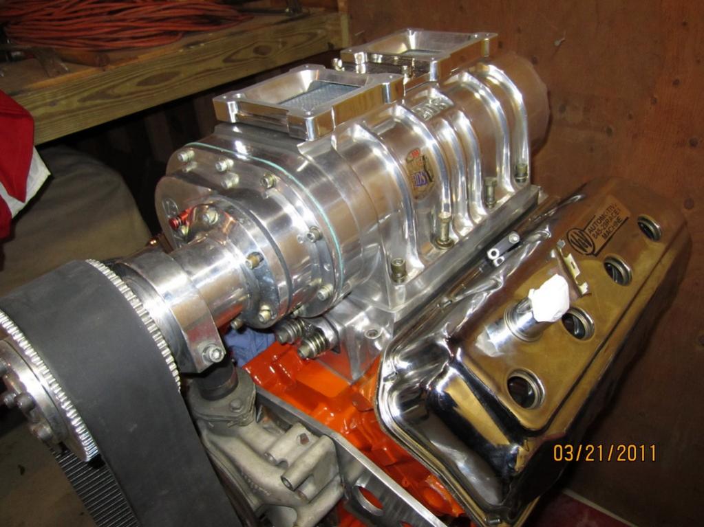

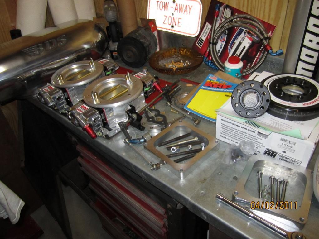

The water pump pulley fitment is done.Installed a new ATI super Damper and it fit nice with no honing needed.Bolted on the the water pump & blower pulley with a 1 inch spacer for mock up and measurement.I am slightly disapointed with ATI.When I spoke with TECH and told them it was for a blower drive system,they provided a part number and told me it's a "bolt on deal".Well,we all know what that means:eusa_boohoo:All blower pulleys & spacers have a 2 inch register,the ATI damper has 2.25 register.So I will have to open up the back of the spacer from 2 to 2.225.I figured the spacer need to be 1.3 inches giving me a few thousands to fine tune if need be.:sleepy2::munky2:

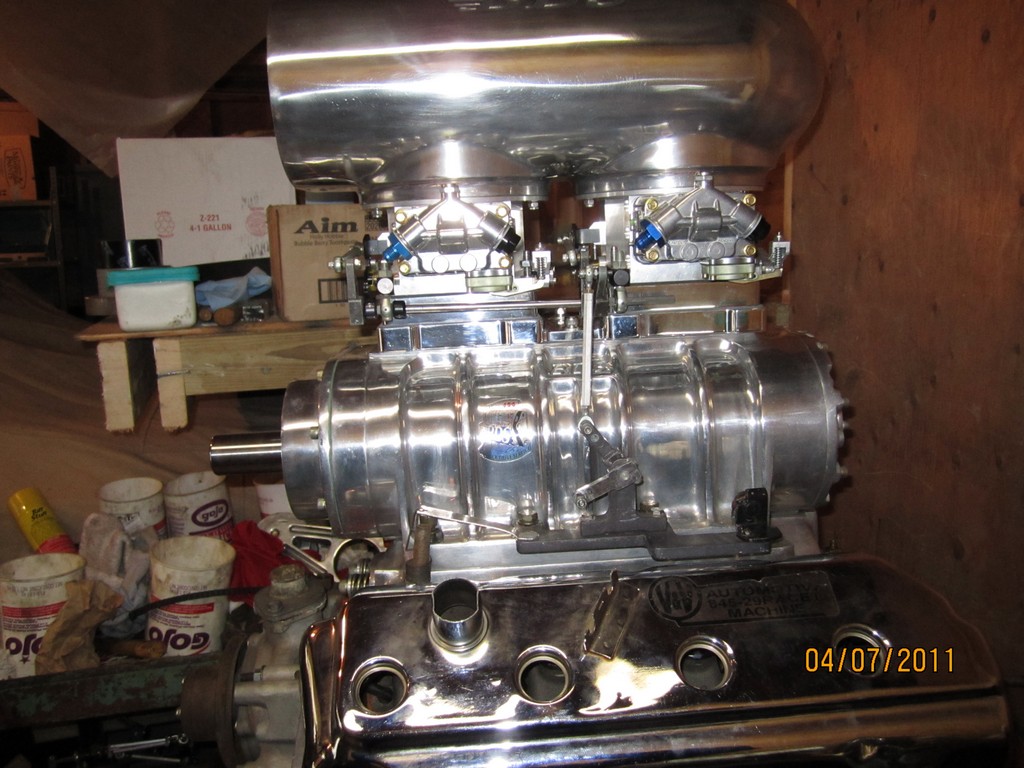

Just got back from Bill's man cave/shop.He milled the spacer down from 1.5 inches to 1.3 and opened up the back of the spacer from 2 inch to 2.25.

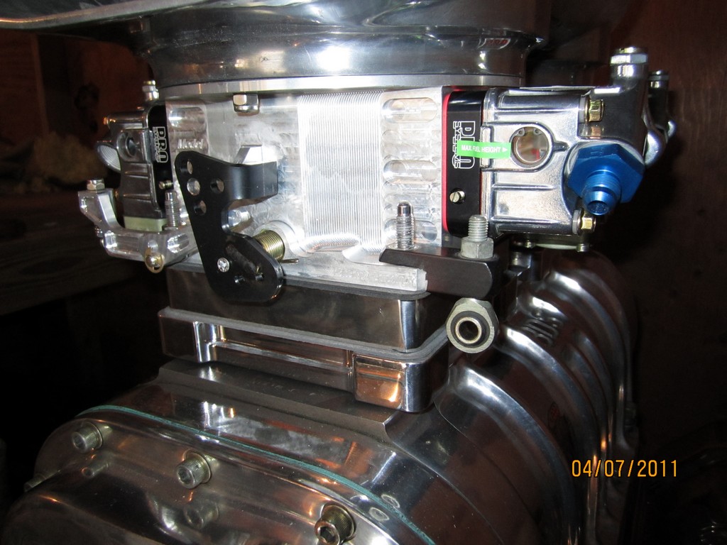

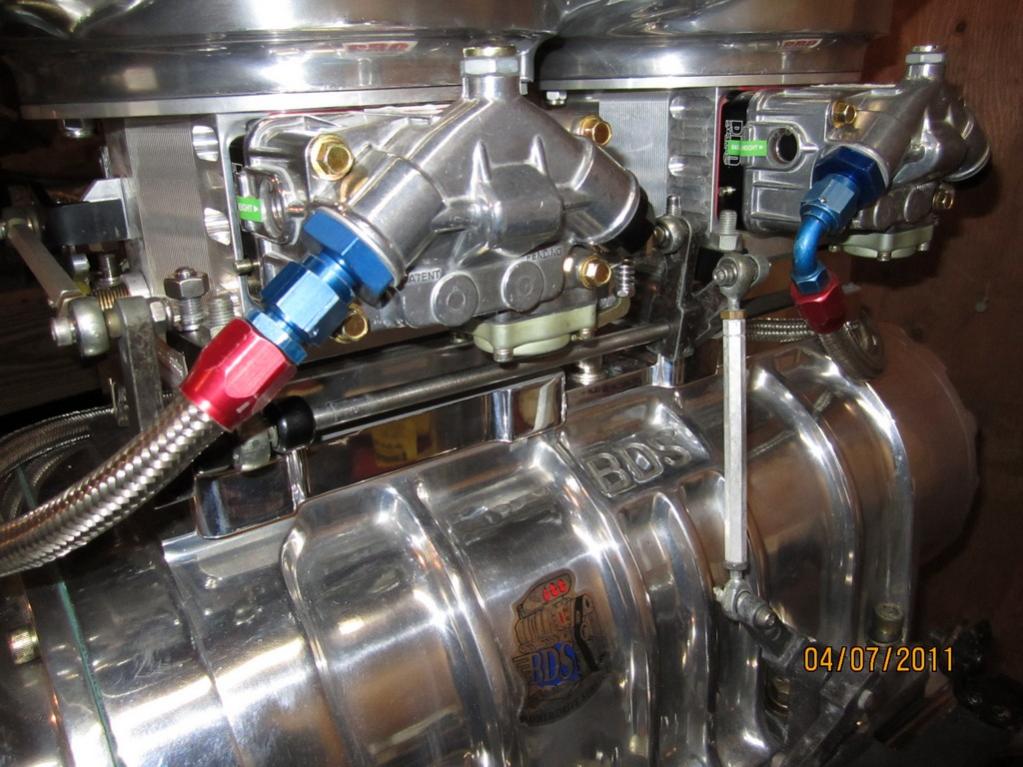

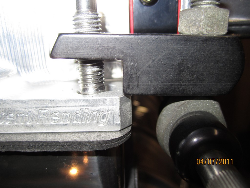

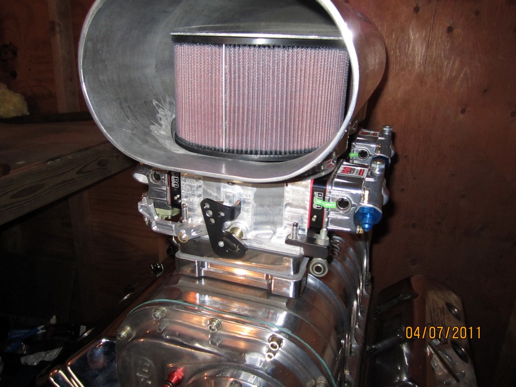

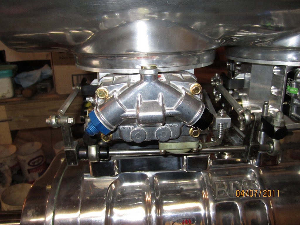

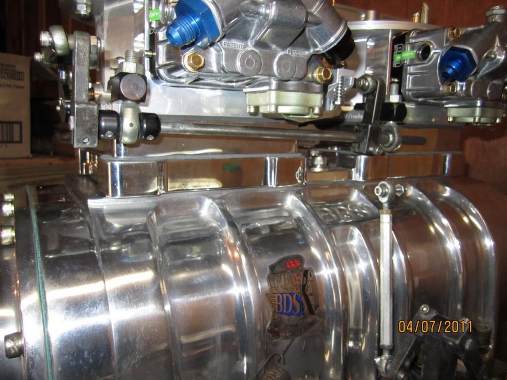

Mocked up the carb linkage,,,,,,,,,nothing is ever easy:eusa_boohoo:

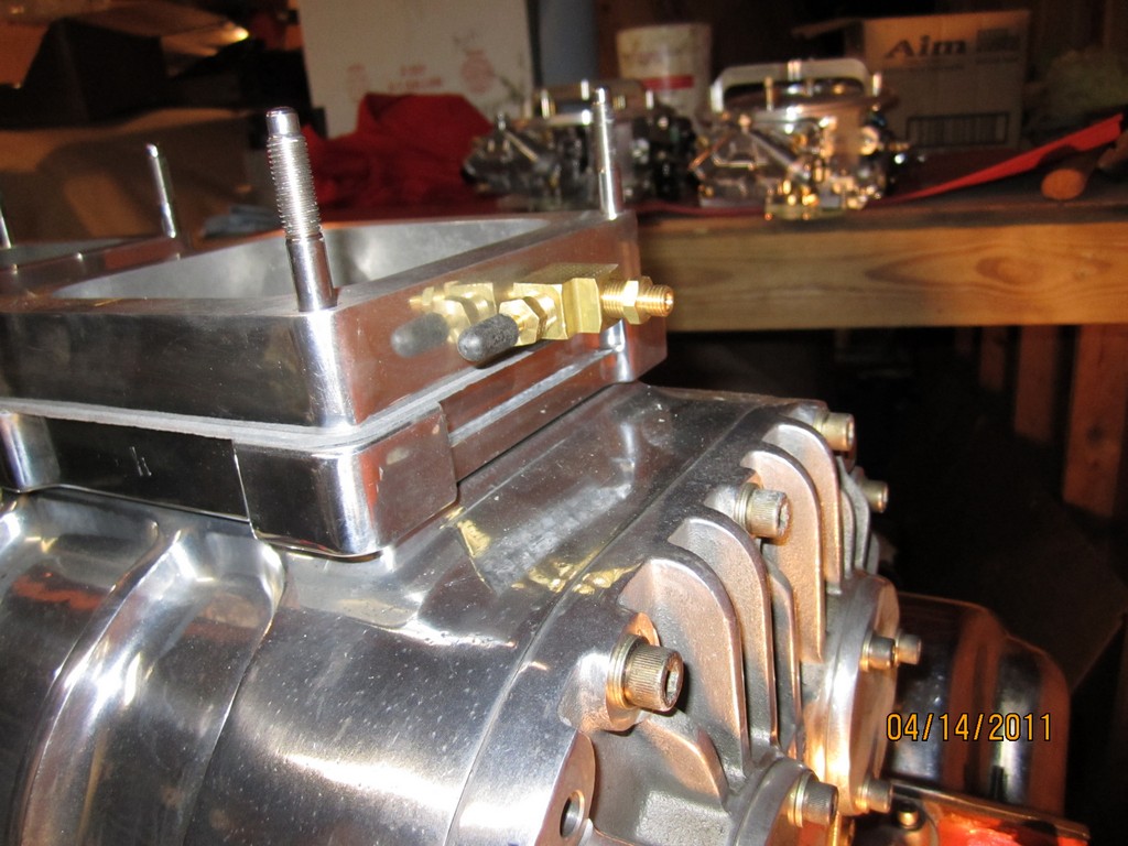

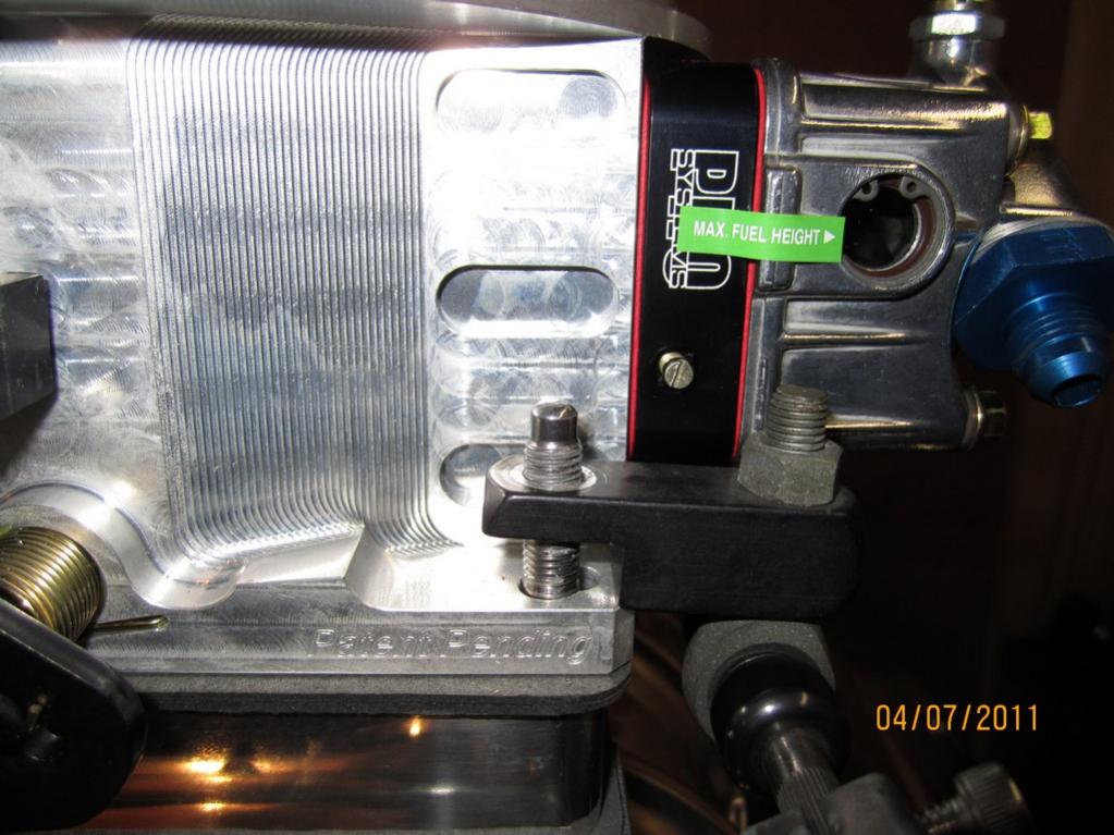

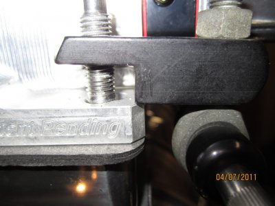

Had to break out the "whiddleing knife":tongue8: Mocked up the carb linkage and got that all set.

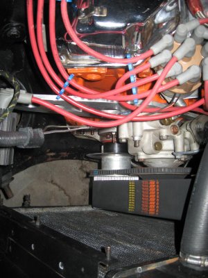

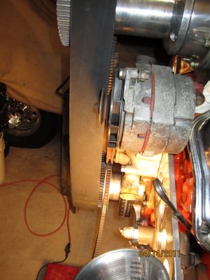

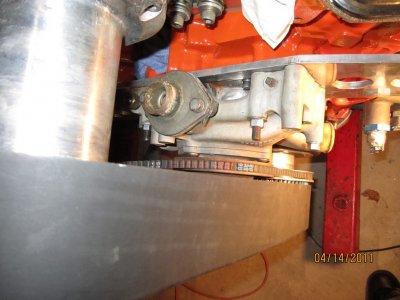

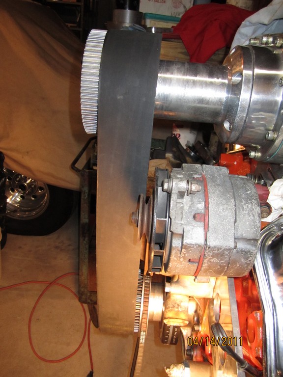

Another situation that comes into play is the alternator will no longer fit on the power steering ear/mount on the waterpump.I will have to wait untill the elephant is back in his cage to mock that up and fabricate some new mounts.:sleepy2:

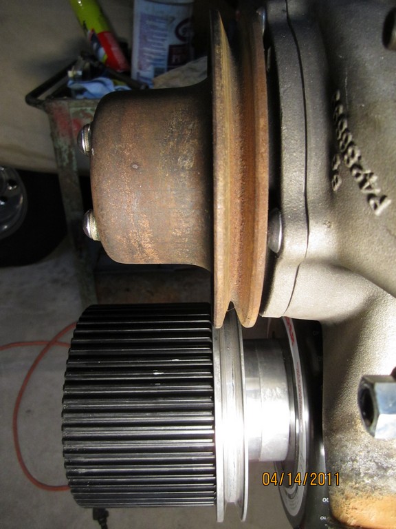

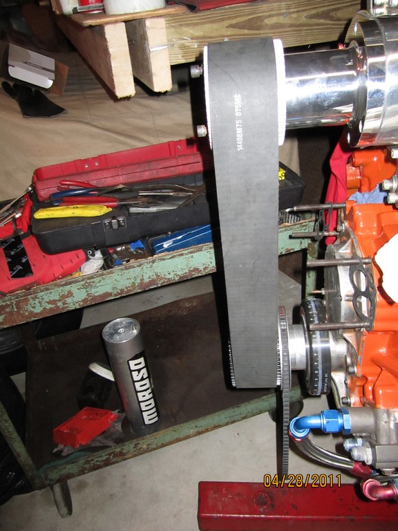

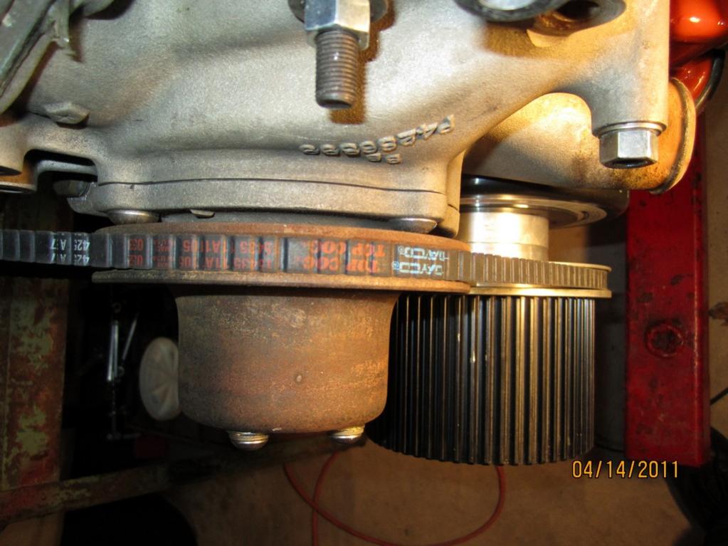

Reassembled the crank drive after milling the spacer down to 1.3 inches and opening the register to 2.25 inches.

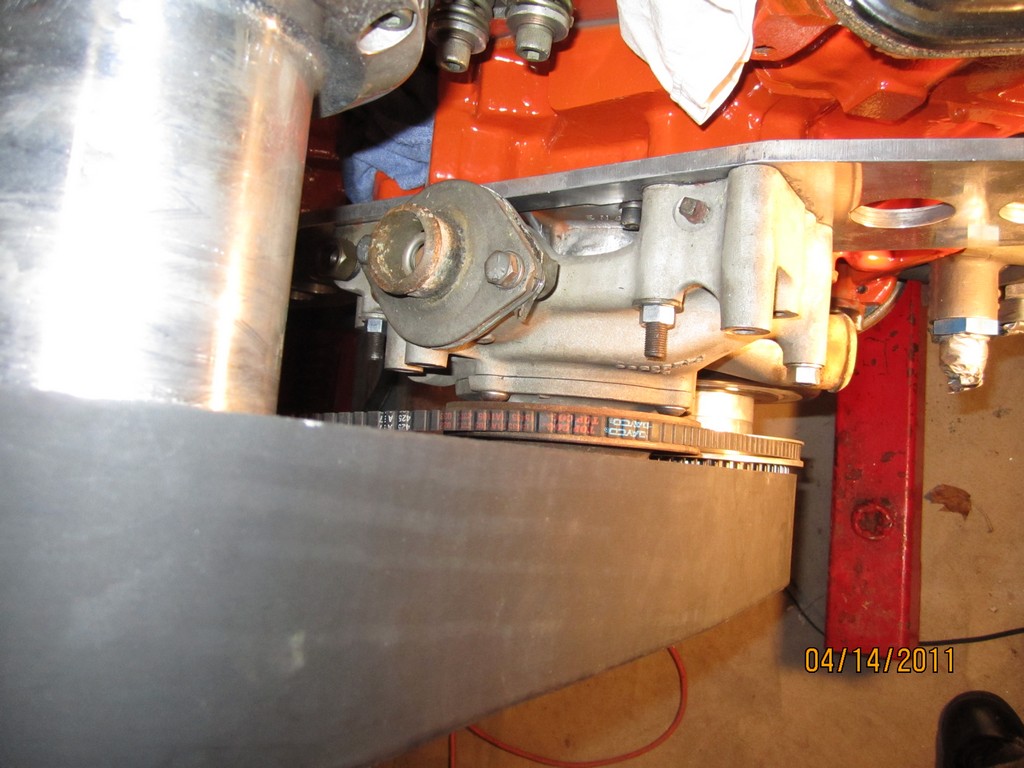

As you might be able to see,it's still of by justa little:eusa_boohoo:Another 15 mile drive to the whittling machine:sleepy2:Had bill take another 100 thousands,back to the garage to mock it up AGAIN:munky2:
BINGO!!!It dead on:icon_pidu::icon_cheers::upside down:In the next set of pic's you can see the blower snout is too long,but we knew that.Also will see where the alternator belt used to be:tongue8:

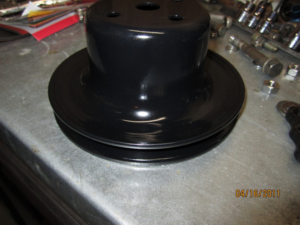

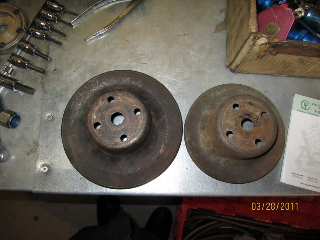

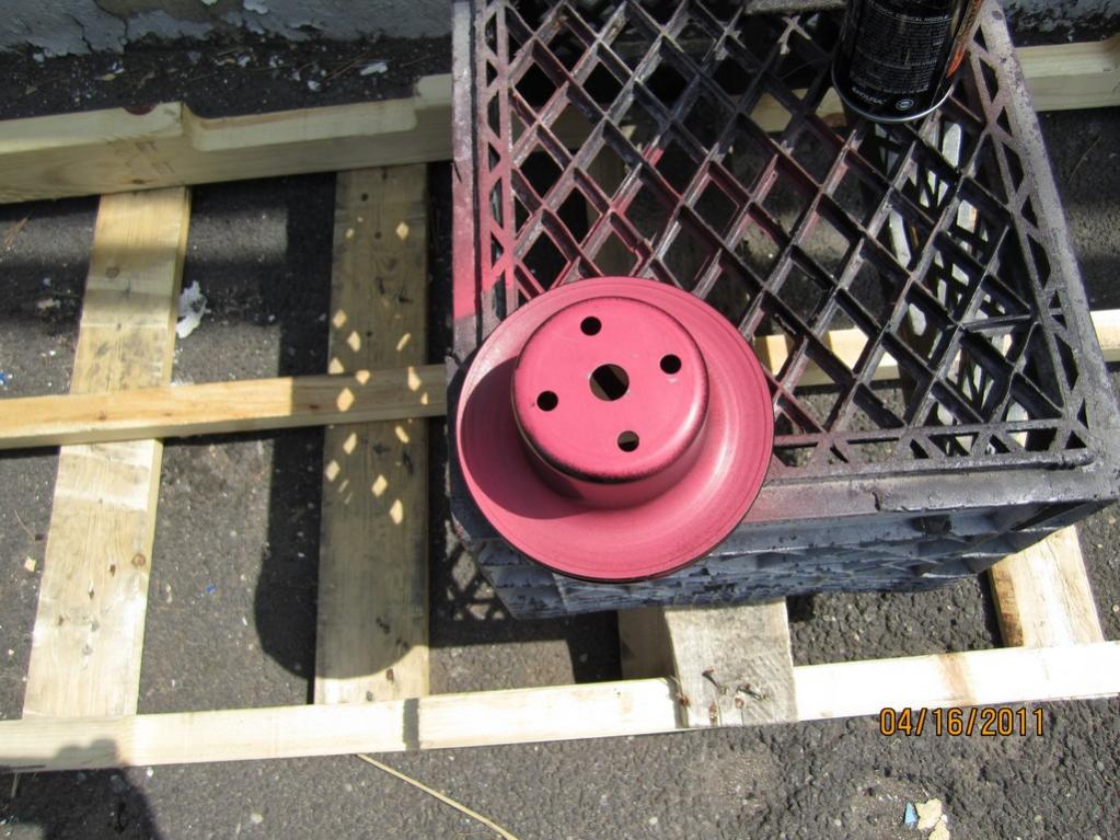

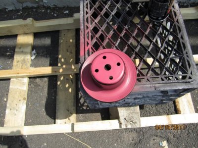

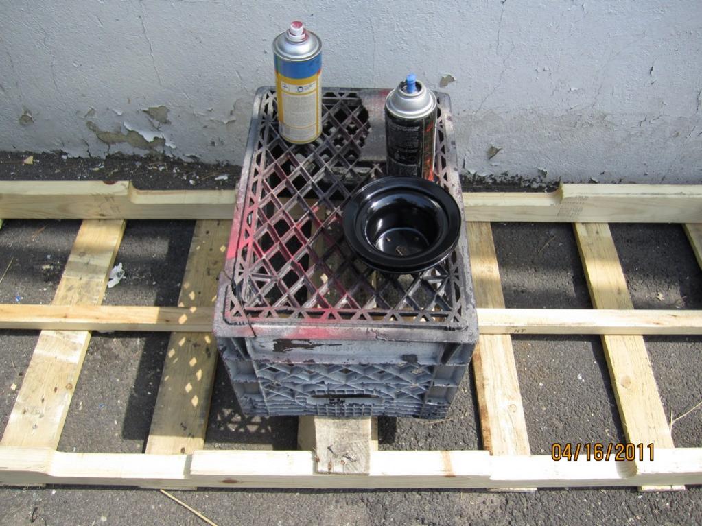

Took the water pump off and removed the pulley.Went over to Jerome's Auto body to use his glass bead cabinet.It's sooooooo nice to use a good machine,the pulley was done in no time at all.Primed it,let it dry overnight and spray bombed it today:tongue8:

Alot of the little stuff that isn't noticed:eusa_boohoo:The 1 inch carb spacers come as cast,musta took me close to 3 hours to a 3 step sanding them smooth,than another hour on the polishing wheel to make that "mirror" finish.The used BDS scoop I picked up a while back took another hour or so to polish:eusa_boohoo:

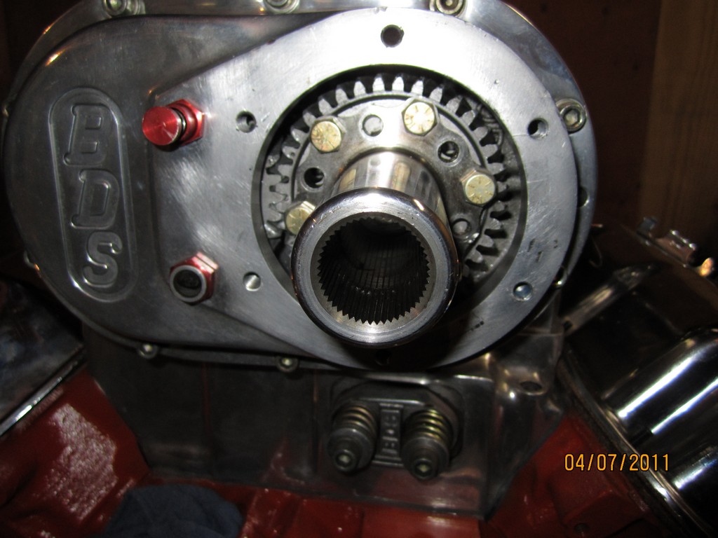

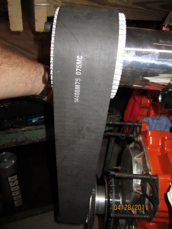

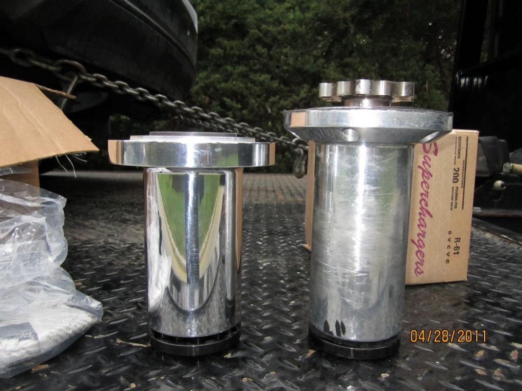

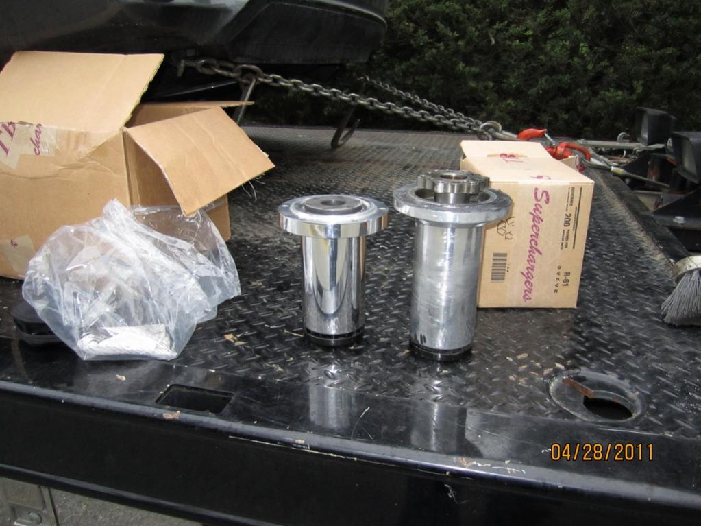

My shorter snout came in Monday and I found some time to stop at the garage and take a look.Popped a few bolts in and it's dead on!!Chippin away!!
