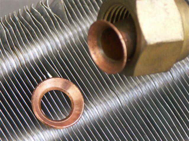

Good advice - don't resort to pipe sealant. If it leaks, there's a chance that one of the mating surfaces isn't quite accurate or has a nick. You may be able to seal it with a soft copper cone washer.
