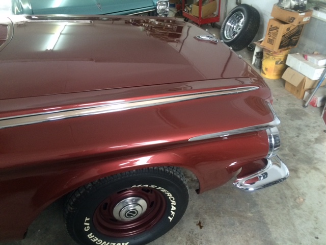

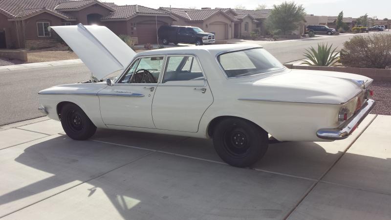

Okay after draining my brain on what to do I have decided to keep the factory look of steelies with dog dish caps on 62 Polara. It currently has 14" steelies. I want to beef them up to 15".
Summit has black steelies at 15x8 for rears with backspacing of 4.5" and for the fronts 15x7 with BS of 4.0". Question: Will these work? Backspacing on front?
I am guessing my existing dog dish caps won't work on 15" wheels. See picture. Question: Where can I get dog dish caps to fit 15"? New or quality used that will fit.
Don't know if I would be good at modifying to make things work unless it's a no brainer.
Also, as per other members here the following tires should fit. 275/60/15 back and 225/70/15 front. Please confirm.
I spend way to much thinking about this stuff. But it is kind of fun digging in.

That was good info. Thanks.
Do you think those existing dog dish on the 14"s in the picture will fit new 15"s from Summit?
They look like a "inside insert" type of cap not a outside. I might be wrong. The thing is they have to be measured to know.
The wheels from Summit won't accept the origanal 14" caps but there are different ways of making them or other caps work, like mentioned in the thread.

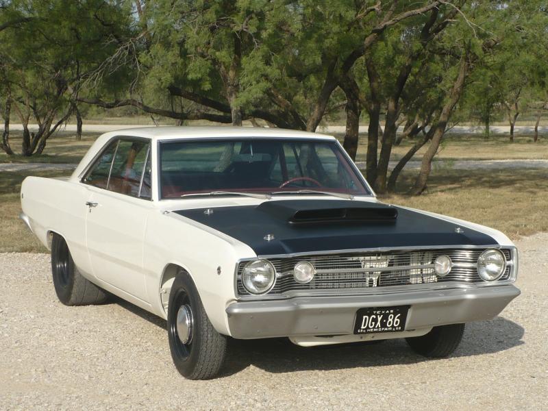

Not familiar with the 62s but I'm running 4" backspacing on my front 8" rims and 5" on my 10" rears on a 69 Charger.

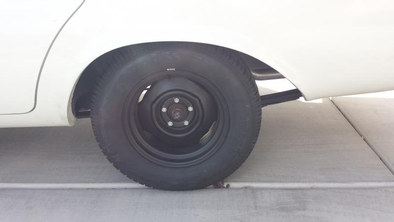

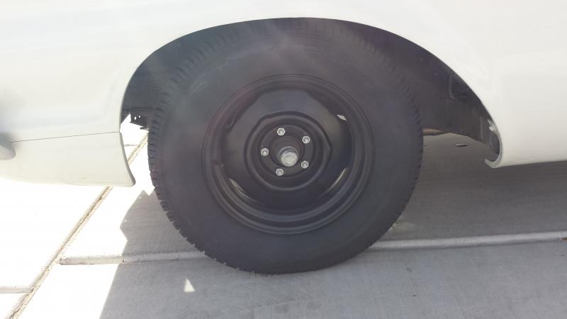

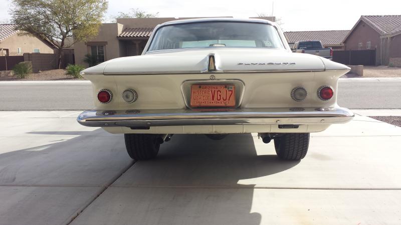

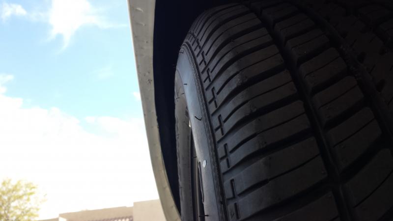

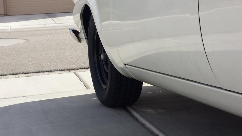

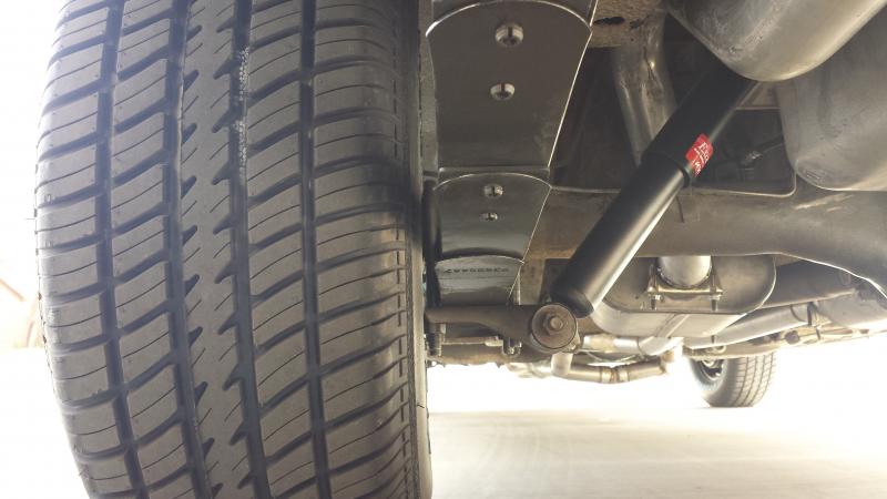

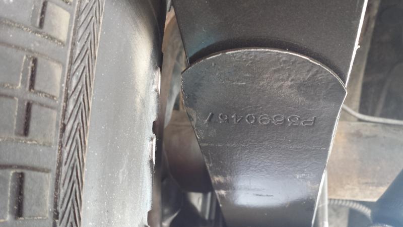

OK, finally got around to taking some pics. 1962 Belvedere. Rear rims are WV "63" 8x15 with Cooper Cobra 255/60-15s and the front are 6x15 WV "63" rims with Cooper Cobra 215/70-15s
The rears have plenty of room on the wheel opening side but the side closest to the leafs are somewhat tight. The MP spring leafs are flared out at the ends so I ground the closest edge off for some breathing room. I like the fit and the look. Just got some later model dog dish caps in to try out.
