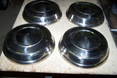

Frank,
Will these hub caps fit your centers?
Thanks, Mike
Yes , the center part of the wheel center is factory sized , I had the center stretched beyond the nubs.
The center fits into a 13.25. rim shell. Standard Mopar steel wheel rim shell.
Frank
Frank
Ok, thanks

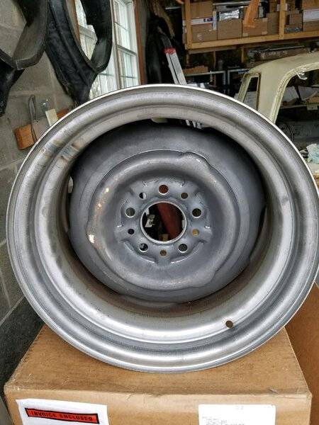

Frank, I have (15" x 8") black steel wheels, (1) has a 4-1/2" backspace, & the other 4-1/8". Can you grind off the welds, re-weld them so the back spacing is 4-3/4" for both rims? I am try to fit 275/60/15 tires on the back of my 67 Belvedere II. Looks as if they will rub the fender well & I have more space inside, towards the leaf springs.
Yep , call the Wheelsmith , they buy the centers from me , I am the only source for that 15 inch wheel center that will accept the 10 inch dogdish cap. If you try to use some original oem 15 inch wheels , they are only 12.75 across and they have to have a special rim shell. My centers are 13.25 , they are made to fit a standard size Mopar steel wheel. Also they will clear some of the bigger brake setups. Also you can buy the centers from me and I can ship them to you or a wheel builder. For more info , PM me.
Frank
Frank, do you know of a wheel builder near me in the Cincinnati area? Scott
I myself can't do it , I don't weld at all. You need to find someone that can do what you need done. I deal with The Wheelsmith ( CA) Diamond Racing Wheels ( WI ) Custom and Commercial Wheel ( CA ) one of them might be able to do it. I will tell you a lot of places will not mess with used wheels. I would think you would be better off , just having new wheels built to the backspace you want.
Frank
Wisconsin , Diamond Racing Wheels , nearest. I would think there would be someone near Detroit , but I don't know of them.
