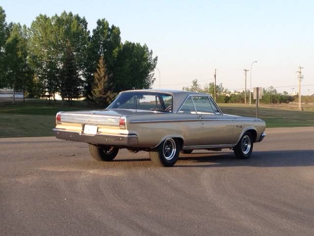

Thanks again for the replys guys! It's funny becuase when I get in the car after not having driven it for a while it takes me a few miles to get used to the "Mopar" steering. Scared myself a couple of times lol. Since the car is going in for a "Super Stock" remake I wanted to replace the box and totally rebuild the front end in an effort to tighten things up a bit. Below is a pic as it is right now.
