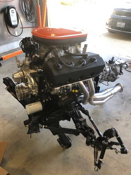

Hey guys I have a 68 roadrunner I’m installing a hemi in with Schumacher mounts
and TTI step headers. My steering box will not clear one of the header tubes. I shimmed it forward a 1/4” and still touches I also tried a Borgs steering box and that was worse. Has any one had experience with this
i have seen some guys 1/4 plate under the k member.

I’m assuming I need to do the same that’s ridiculous considering TTI guarantees them to fit in the price you pay for them of course mine are ceramic coated and polished. I will call them Monday just to confirm nothing has changed thank you

yes that’s what i tried still not enough
you moved the box forward but did you put 1/4 shims between the the frame and k member. i have seen this done with the hemi in the 68 dart and 69 gtx both hemi cars and manual steer boxes. one was a auto other was a 4 speed. on your perches are they long gated to move up or down. but i would be all over tti about this before i bent them up. just a couple of cents worth good luck
I are taking about shiming down the kframe? And yes I’m going to call them on Monday less then impressed with this
yes like i said i have seen it on a couple of mopars shim the k frame. good luck
I have a hemi borg box tin man motor mounts no issues
well I spoke to TTi and they have made a change in the header since I bought mine in 2018. They told me to try shimming the drivers side motor mount 1/4" if that is no good then bend the header or buy a new drivers side one.
