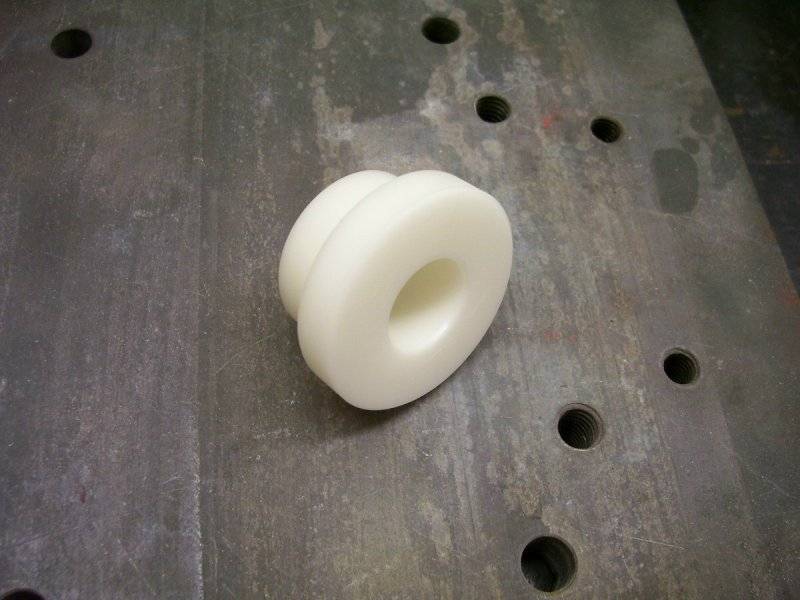

I tore down my 62 Savoy's steering column and I noticed that it only has a seal/retainer on the lower end/ engine compartment side.
Can a bearing be added to the end of the tube like later columns have?
I had a delrin one made for mine. Going to use it plus the rubber/nylon one.
I had a guy from a machine shop whip it up after I gave him id and od dimensions.
