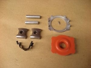

I Noticed There is a Small dowel pin in the Steering wheel coupler kits i googled pics of. Where does this Pin go. Thanks
View attachment 352534 I Noticed There is a Small dowel pin in the Steering wheel coupler kits i googled pics of. Where does this Pin go. Thanks
That small pin goes in the housing once the assembly is put together. There is a small hole near the end of the housing. If it is still in there, you will have to punch it out to install the new one. It is designed to keep the the assembly from being able to come out of the housing.
