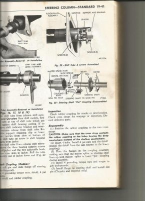

Check to steering coupling there should be a dowel in the top of it that holds the shoes in place. This will also prevent the shaft from going into the coupling. I have attached below the diagram for the coupling.steering coupler detail.jpg
Check to steering coupling there should be a dowel in the top of it that holds the shoes in place. This will also prevent the shaft from going into the coupling. I have attached below the diagram for the coupling.View attachment 220455
The dowel hole and pin is great but many don't have them. Sounds crazy but check
to see if your coupling has it. Mine doesn't. You could drill a hole for the dowel. Big blocks such as mine stuffed in a 68 Dart come too close to the coupling which has rubber inside with a plastic cover. The coupling will melt and cause grease to come out. Most people wouldn't think of checking but with the coupling missing the dowel hole and pin and the collapsible steering column it spells danger. I had 2 Darts that did not have the dowel holes.
