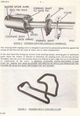

steering couple clamp
When restoring a column completely you do not have to use it. That was a service item/warranty replacement when the car was serviced and if that service involved the column.
I place it on all of my restored cars for added security.....rrelatively inexpensive and cheap insurance.....
You can buy them on eBay or Mega Parts.

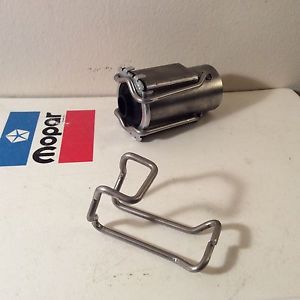

What is a "Steering Couple Clamp"? Just curious?
It goes around the coupler really helps keep the rubber seal and cover intact I use them also.
I like it. Where can I get them? I just replaced the gear box on my Barracuda and it's hard to get that part to stay closed now. I assume they are the same for A bodies and B Bodies. I would like to get a couple.
eBay $13
two different sizes 2.5 and 3 I believe the three is the one on my truck.
