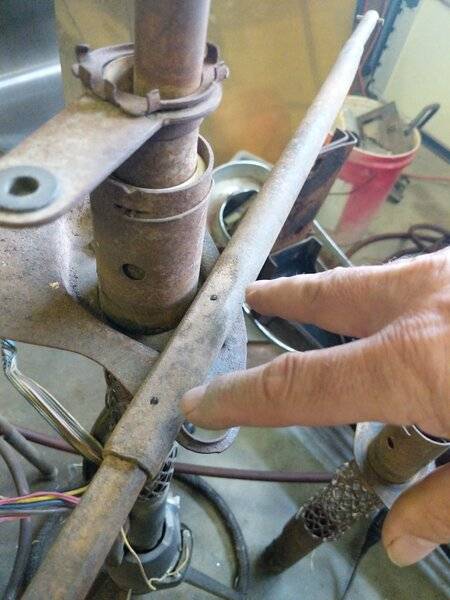

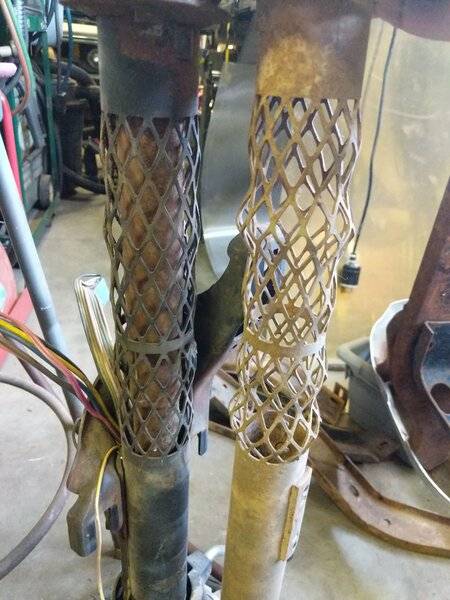

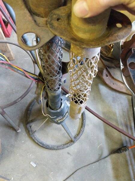

Its definitely not bulged in the middle. Where are the plastic share pins, I couldn't find anything. This is strange, I have a before picture and the steering box looks like it was in the same place and the coupler was almost all the way down.
The bulge would look like this:

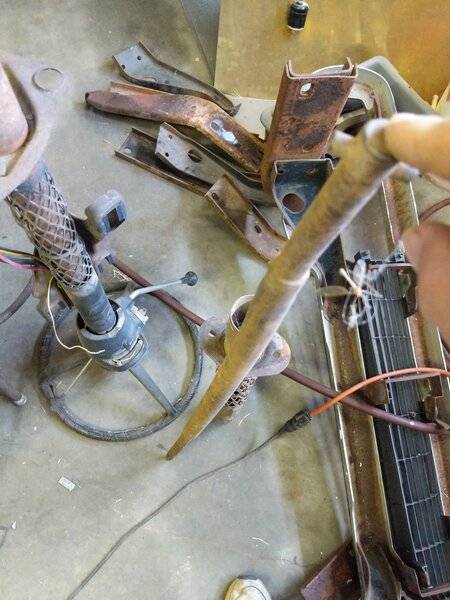

Picture three is a steering shaft that came from this tube:
Picture for I'm pointing to the pins in question and there is a lot of shaft that is engaged so to move it 3/4 of an inch wouldn't be too big of a deal.
Was this converted or originally set up for a manual box?

My column is definitely not collapsed. I'm not sure if they used the same column but yes this car was converted from an auto to a manual.
