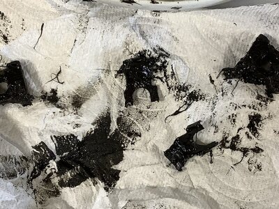

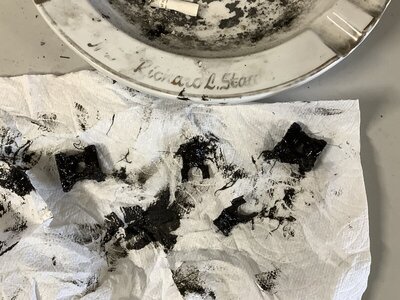

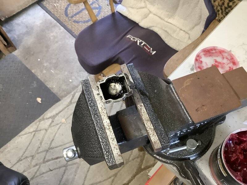

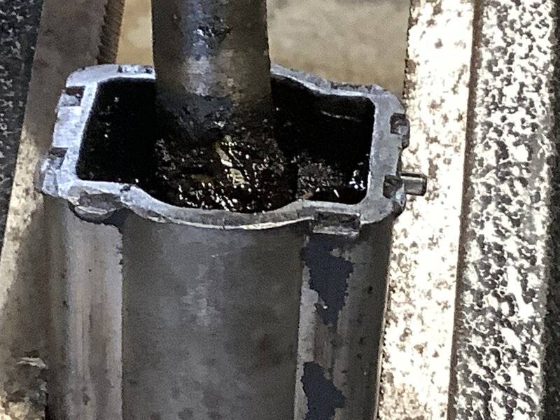

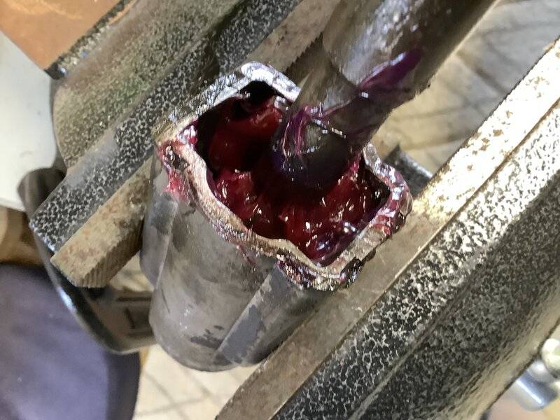

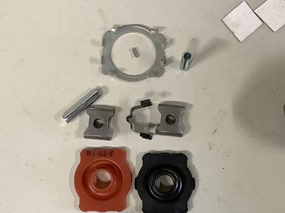

I decided to tackle the steering coupler today and got everything back together. Posting some pictures for anyone here to reference if needed. Had the typical broken spring inside and of coarse the shoes from the rebuild kit were drilled to small which was expected.
4F46665B-90C0-4B90-8FDD-1D318562A158.jpeg 069DA65C-01E9-4C7B-90A4-BCB78105BAC4.jpeg

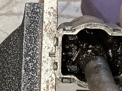

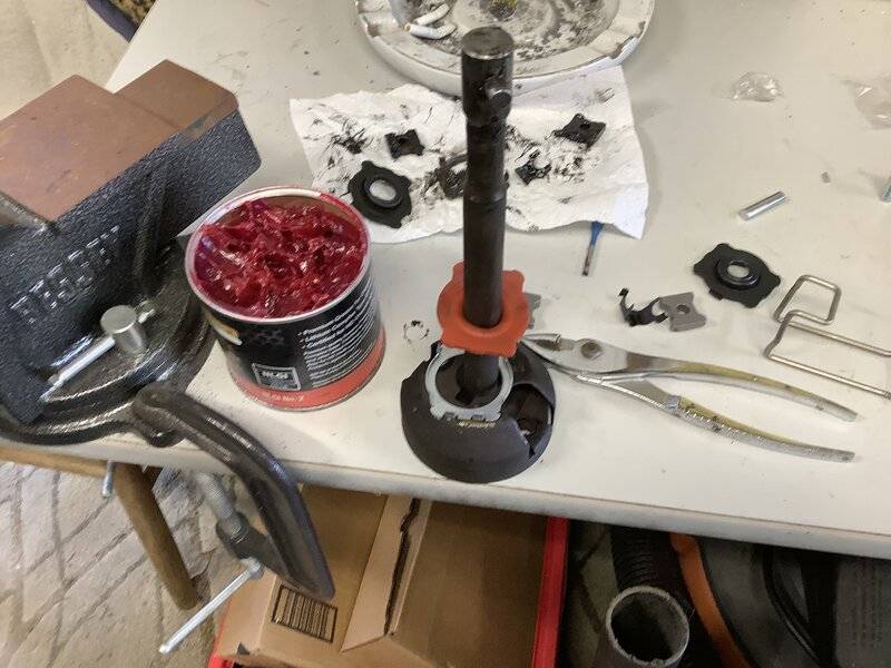

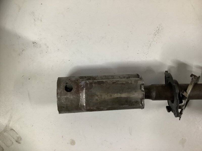

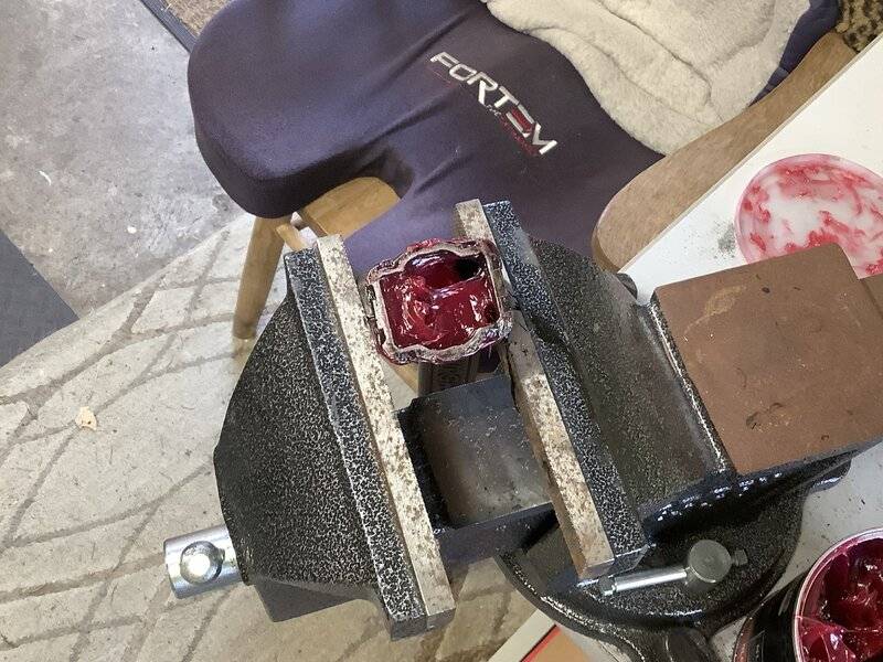

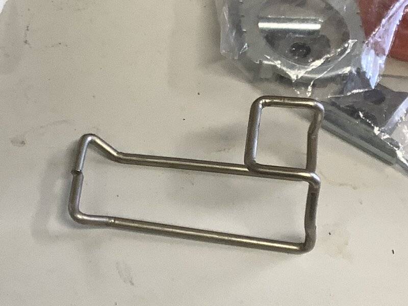

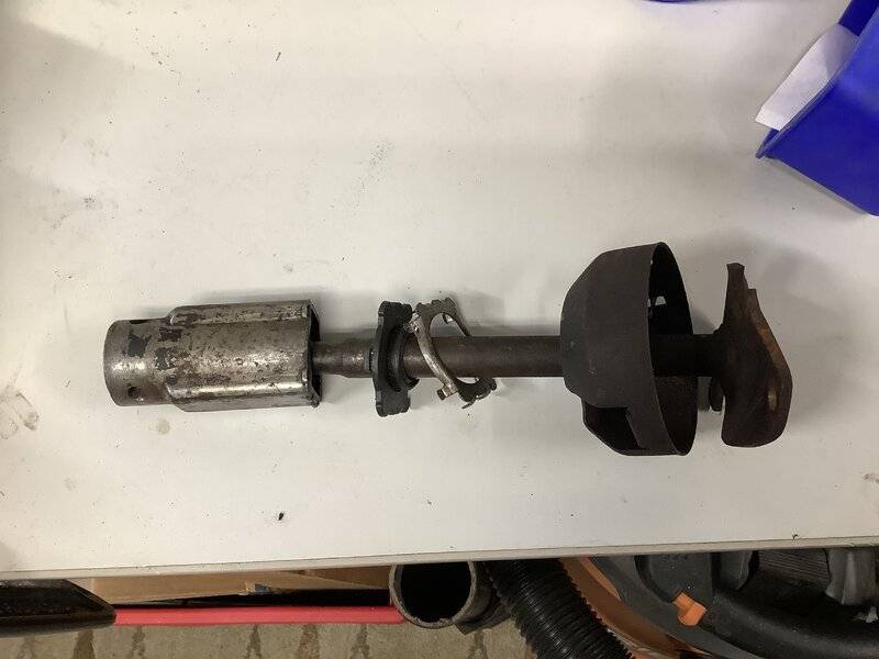

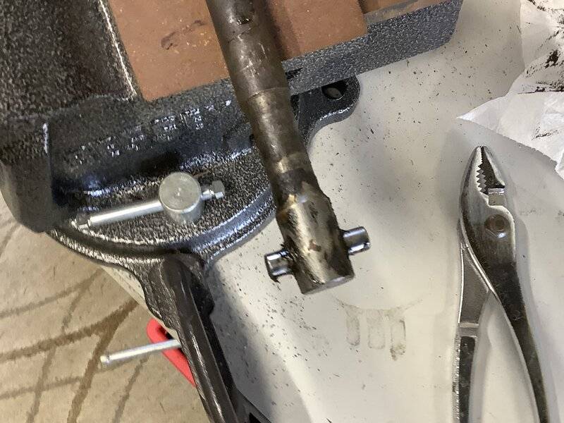

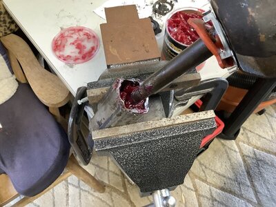

Cleaned out the case and put fresh grease in. Assembled the shoes and new spring making sure they’re properly oriented in the case.
FAB3B194-6728-4F38-8EB8-F9398B84D61F.jpeg 1C4B5CAF-F9D7-4172-9D2A-082AEE353AB5.jpeg E6A02271-546C-4186-816F-5B4EB7693DF5.jpeg 9EA1D20E-6C72-434C-8311-38F75BC700D0.jpeg 1BDBF390-5F45-4EEC-AEE6-7FB25C75FB7D.jpeg 557B49C3-E224-4CD3-B3FA-57C2B9139B6A.jpeg

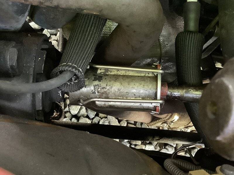

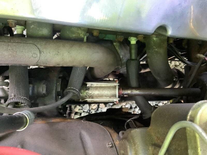

Reinstalled on the car and secured the spring clip to keep everything tucked in until the next time.
