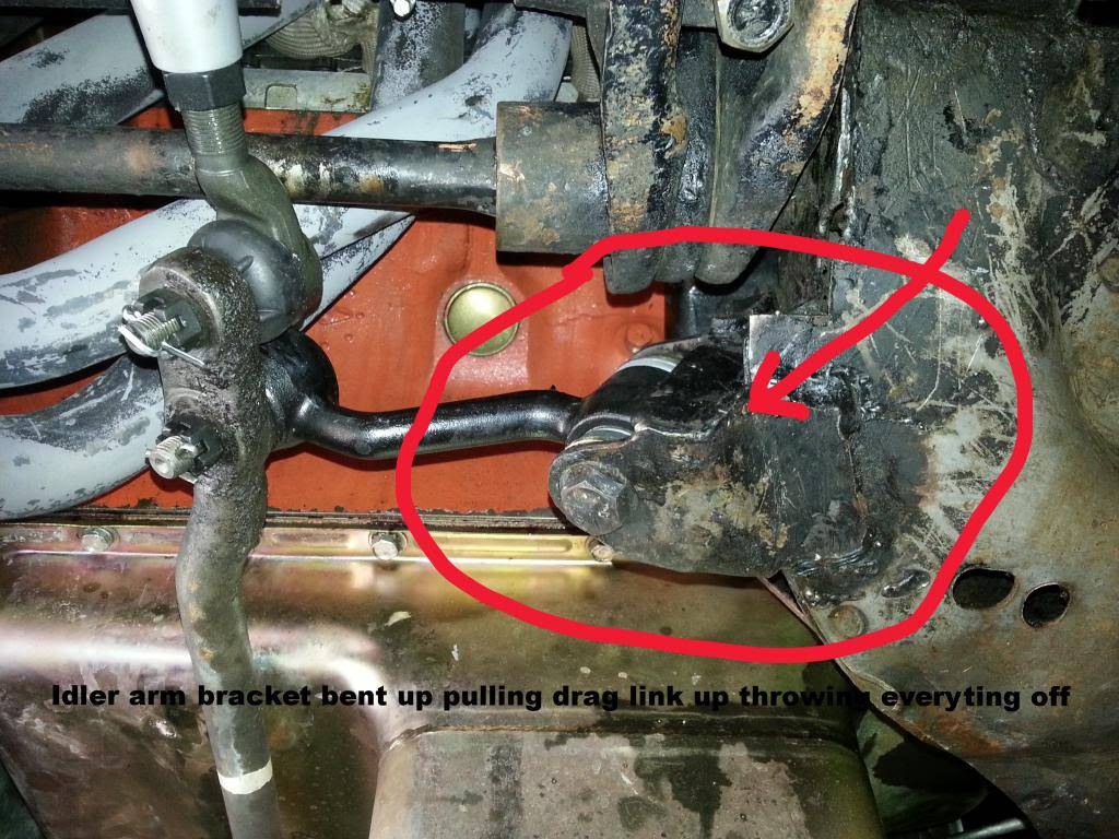

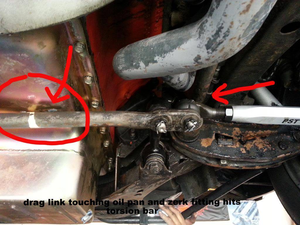

Adding more information (and possibly confusion) for others that happen to come across this same problem - where the cross link bar tilts up on the passenger side hitting the oil pan and the tie rod end and/or zerk fitting hits the torsion bar. I have the same exact problem ... interestingly enough, after upgrading to the PST system. And why I quoted the message below - my idler arm mount looks identical to the picture. So either my roadrunner had the same exact "bottom out" or it truly is an issue with the idler arm provided by PST (or other replacement) idler arms as the original op mentioned he also changed that prior to upgrading to PST.
So it has me wondering if there are different idler arm lengths (maybe having to do with manual vs. power steering for the 1968 - 1972 roadrunners)? Mine has manual steering btw.
And the fix I'm going to try - I plan to try the 1973/74 idler arm to see if that corrects the problem. Always wanted an extra inch - lol.
Had the exact same thing happen to me after upgrading with the PST kit and the solid tie rod sleeves, turns out one of the previous owners bottom'ed out the car so hard it bent the welded on bracket to the steering arm and raised it up, never noticed it until we put on the bigger tie rod ends on then it was obvious, we had to cut one of the sides of the bracket off & re weld it in place and add in some gussets for extra support so it would not bend again. all good now. Was confusing at first then it all made sense, unfortunately after that you find other bent parts on the k member :(

I just started a thread on this very same issue ...tie rod hitting the torsion bar ...actually, my zerk fitting on RH side.
My center link is 2" higher on the RH end, but fortunately no oil pan issues. Have you tried the 73-74 idler arm? FBBO member '70 RR' said that gave him 3/4" clearance on his oil pan. That's likely to give me an extra inch or more at the end of my center link. I'm curious if you had success going with the 73-74 idler arm.
