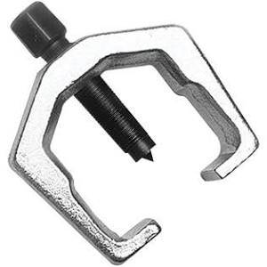

The pitman arm is tough to get off. You will need a pitman arm tool. Here is a link to one at northern tools but they should have them at your local parts joint. The Idler arm should just unbolt from the frame. Once you get tension on the bolt. Whack the pitman arm with a 4 lb hammer and off it comes. Make sure to remove the big *** nut first though :)
PITMAN ARM TOOL

For the pitman arm you need a pitman arm puller like this.
https://mobiledistributorsupply.com...MIzaCXr4fG2AIVXbbACh19SAG_EAQYBSABEgJLzfD_BwE
Most of them I've pulled have been on there good. Tightening up the puller and giving it a couple good taps with a hefty hammer every so often as you go can help.
You can probably borrow these tools at local auto parts stores if you do business with them.
PITMAN ARM TOOL
These work too & I have a couple different sizes. When I did this job 2 weeks ago though, the fingers of my tools wouldn't fit between the center link & either the idler/pitman arm (you can't screw/wedge if you can't grip the center link bar), so I just pulled out my big 1-handed sledge. I have used these tools successfully on other cars + fits one side of my Road Runner and they work in most cases.
