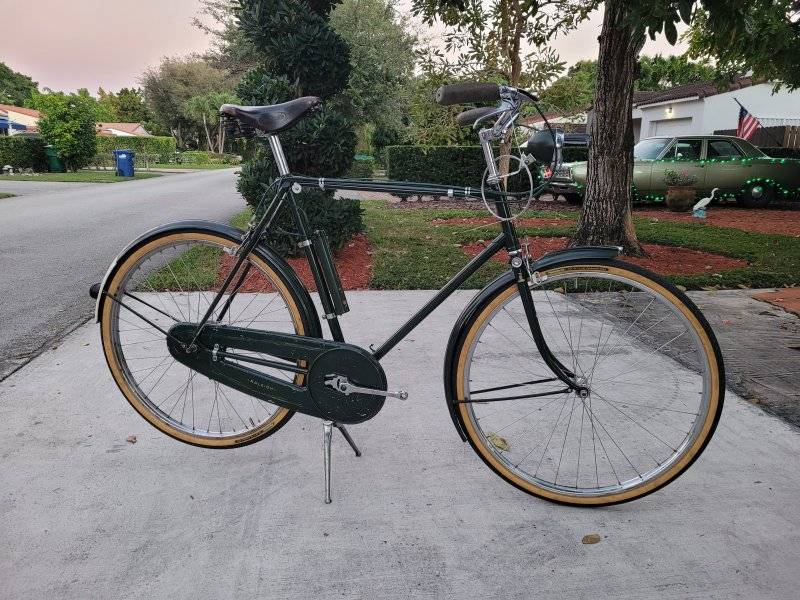

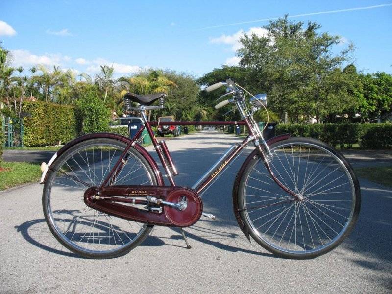

Interesting tidbit: My other hobby are vintage English bicycles, including those with very slack frame geometry. Rake and trail of a bicycle's front fork (and the headtube angle) are, in a way, a manifestation of caster and trail. With access to the right bikes at a slow enough speed (anything that's not a crawl tends to self-right itself thanks to the gyroscopic effects) one can experience certain elements - granted, not all - of auto steering.
The self-centering isn't present due to the narrow tire width or the single track of rubber, but one can experience some of the elements of excess caster with some bikes. You can feel the flop at low speeds when controlling this '79 Raleigh-built Rudge (based on a pre-1940's design) with its extremely slack angles:
This 1950 Raleigh Sports Superbe Tourist with a more conventional 73/73 degree frame doesn't have this flop.

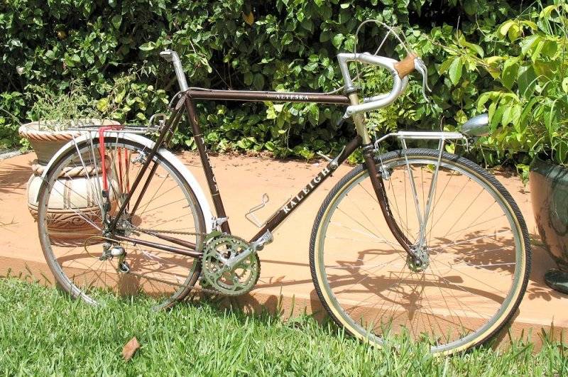

This pile of crap 1984 Raleigh Alyeska I used to own could be induced into shimmy; the fork had been jigged incorrectly from the factory. Though the fork was cold-set straight with proper alignment tools to get the wheel to sit straight, the blades between the dropouts and the crown were never identical to each other. The front rack (shown here only as a mockup) was enough to reliably replicate the shimmy once one hit about 17-18mph.

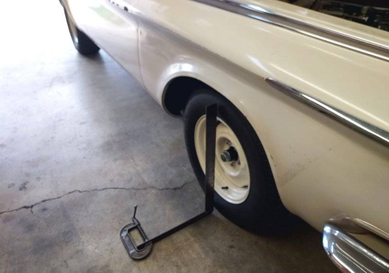

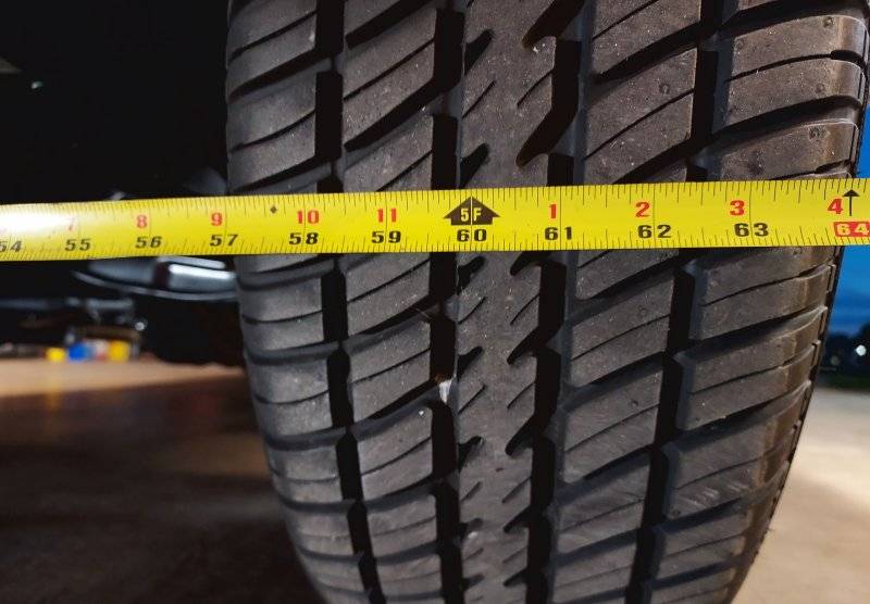

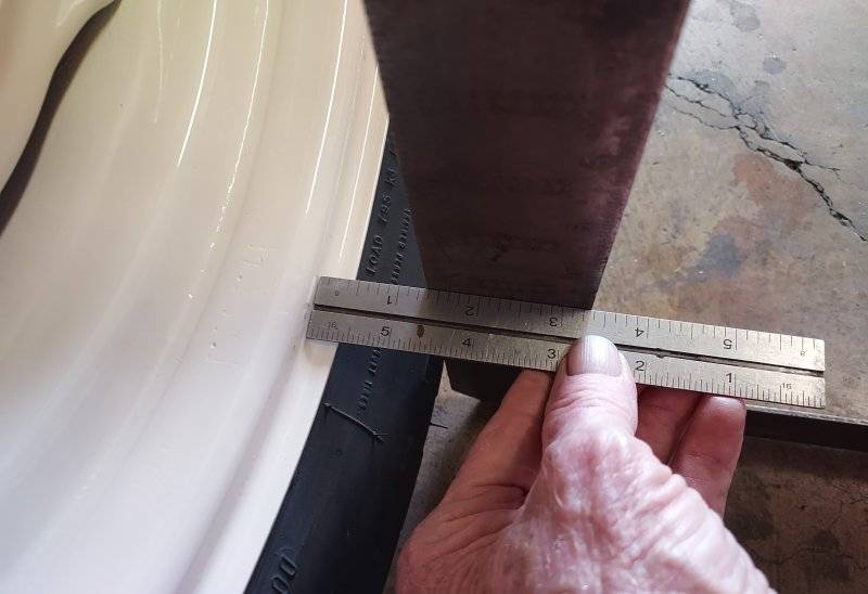

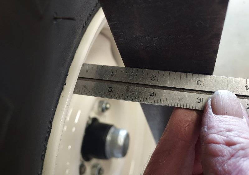

I rebuilt my front end last year. You must start with all new components. I set everything using just a tape measure and a two foot square.

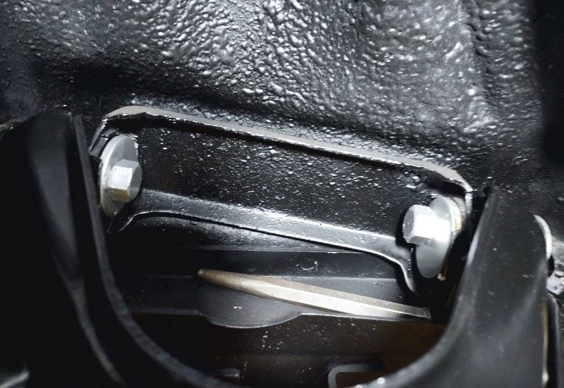

When setting up the upper control arms have the rear adjuster turned all the way in and leave it there. The front adjuster will be used to adjust your camber plus or minus.

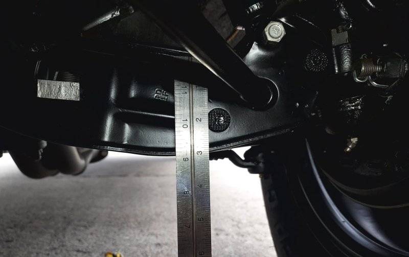

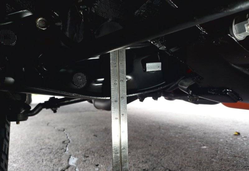

Ride height needs to be determined before anything. I adjust from the lowest point on the lower control arm. Make both the same. If the adjusters are clean and greased you don't need to jack up the car.
Setting the camber with a two foot square.
Keep a check on toe in when changing camber.

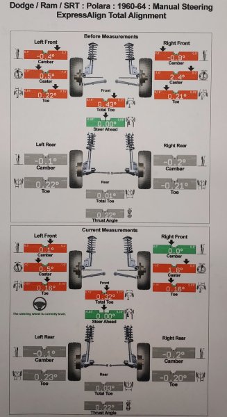

Roll the car back about 3/4 the length of it and foward after making adjustments. This is what I ended up with at the alignment shop and what corrections that were made to even out camber and caster. He closed up the toe a little also. Thrust angle is almost a 1/4".

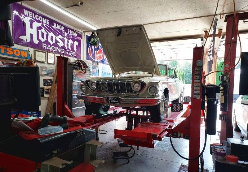

I think the biggest problem is not finding a front end shop that has a tech that knows what he's doing.
This guy had no problem with me bringing my numbers and checking what he was doing. We discussed what our goal was and where to leave the settings after trying different settings. Sometimes you have to split the difference when one setting throws off the other too much. Getting things equal on both sides was more important to me.
This was done with stock components. More than likely the offset upper control arm bushings would have gotten me some negative camber. The car handles great, steering returns better than before, tracks good. It's standard steering now, see how it acts when I convert it to power steering in the future.

While I applaud your initiative and your efforts, I don't see how you can get accurate camber readings by having a framing square resting on the sidewalls of the tires since they will bulge at the bottom. Even resting on the wheel edge does not take into account any wheel runout that might exist. The hub mounted Longacre gauge seems to be a better way to go.
His picture is shown measuring from the rim, tire bulge is irrelevant in that case, I can't see rim runout being a significant factor here if we are using tape measures. A simple spin test visually will indicate if it is enough to be concerned with IMO.
This is the same approach I use also - turn the rear adjuster all the way in on both sides and adjust camber with the front adjuster. Check caster. If one side is more caster than the other then I adjust both front and rear adjusters on the high side, out slightly to maintain camber but lessen caster to where it matches. Pass side caster a bit higher than driver side is preferable to combat road crown effects as Rebelrouser noted.
As jc62 stated you stay away from the tire bulge and measure to the rim itself. I do check runout of the rim because I've had the problem in the past with inferior rims. Once set up on the alignment machine the sensors take in account for any runout.
What I posted is to get you close to specs before finding a good shop with a alignment machine. You can see from the readouts how close I was. I wouldn't accept my settings as final.
