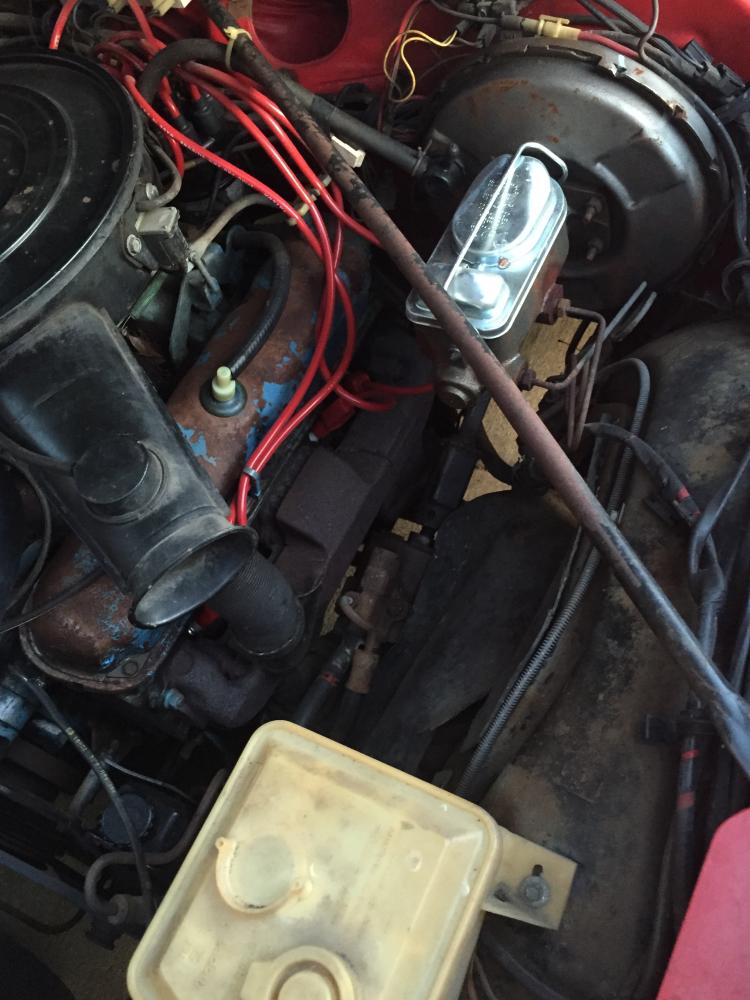

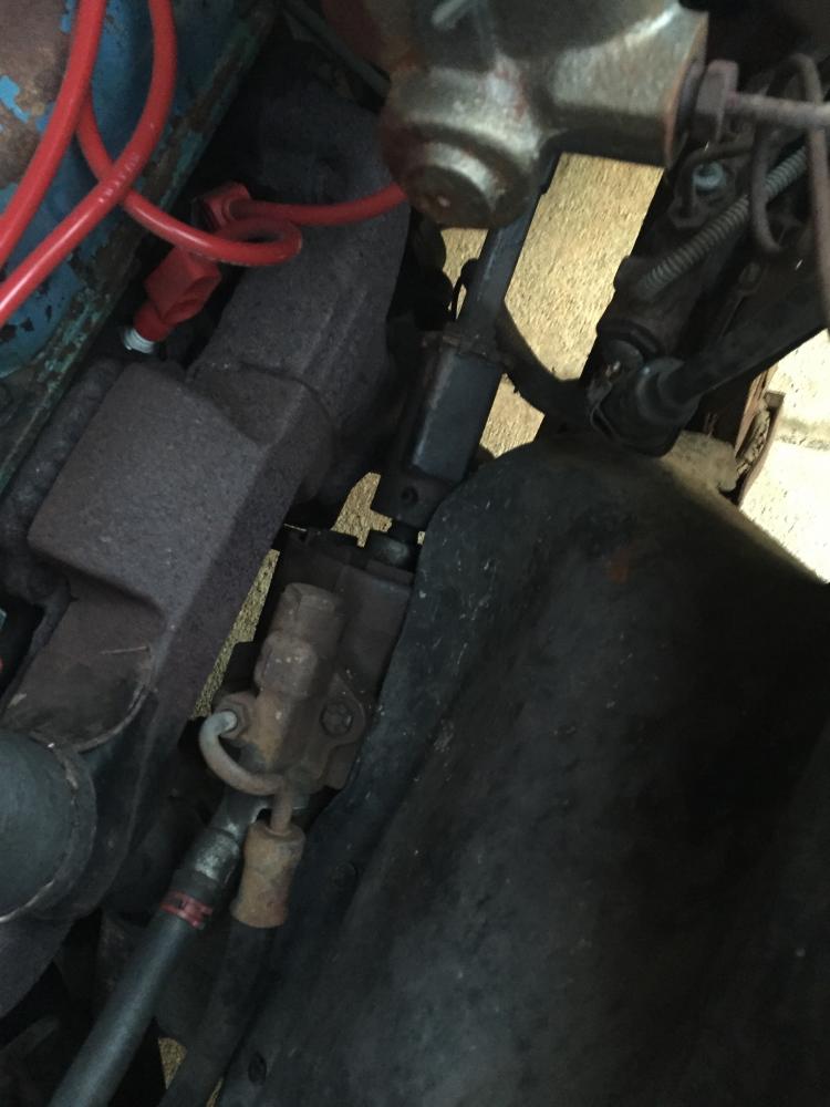

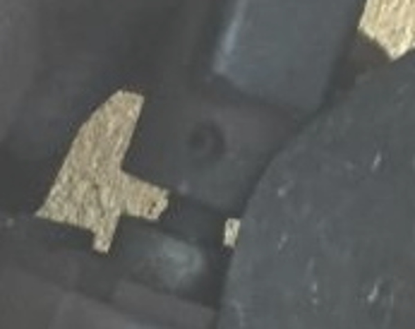

Just wanted to give an update on this issue. I took the column apart down to the lock plate. I replaced the upper bearing. I did not see anything else that was broken or loose. I put everything back together and still have the problem. I had someone turn the wheel for me while I watched the steering gear under the hood, and I noticed that it looks like there's a hole where a pin or bolt should be (see pics). Could this be the problem?
there's supposed to be a roll pin in there that holds the collar to the splines...could be it!
That roll pin has nothing to do with "slop in the steering" unless the coupler has come "off the splines".
What it DOES do is prevent the coupler from working up off the splines IE reducing the amount of spline engagement. There's a groove in the box splines which the pin engages.

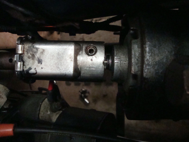

Frankly, I cannot tell from your photo. It almost looks like the pin is in there, which is hollow
What you want to do, there, is to get someone to move the wheel back and forth while you watch. Look carefully at that entire area, the shaft coming into the coupler outer body, and see if there is relative movement. There should not be. Then look between the coupler body and the box shaft. Again, the two should move in unison.
Then look at the shaft moving relative to the pitman arm below. There will be a little play with engine off, but running, nearly none.
Then look underneath, at the idler and pitman. should be no movement or play between the balls and the pitman arm or idler arm. Should be no up/ down movement of the ider. last check each tie rod end. Look for movement, get under there and wiggle and shake them.
