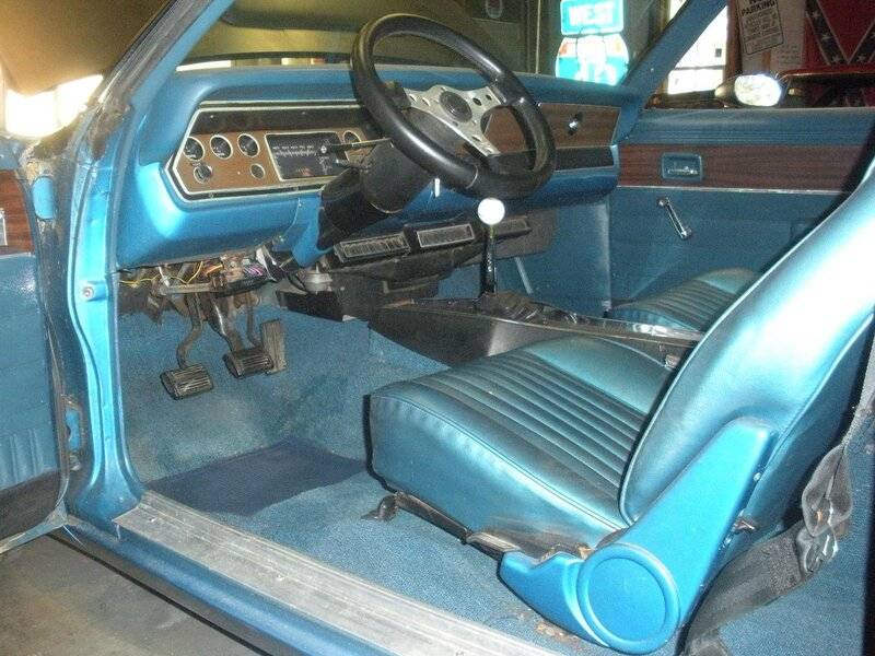

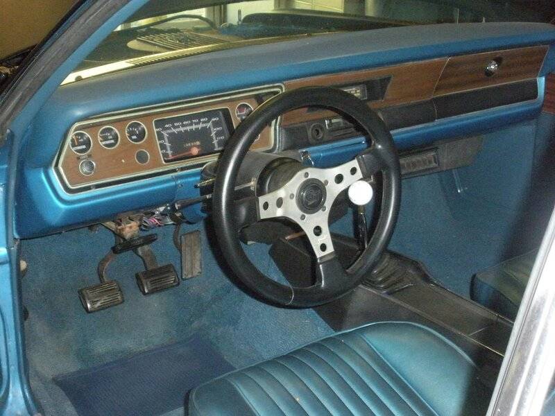

Another change that I have in mind is a tilt steering column.
I have 2 columns from mid 70s Chrysler Cordoba models. These are built by Saginaw and very similar to GM steering columns. Years ago I modified one to fit in my 74 Duster:
Unlike most newer cars, the old style tilt wheel columns had a great range of movement with several settings to choose from. New cars with air bags have a limited range.
The wiring is one small hurdle. The key would need to be matched to the door locks. I'd need to find a locksmith that could reset the tumblers in the door locks to match the column.

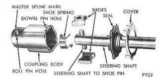

I’ve found a lot of improvement changing the steering shaft coupler from stock to the borgenson u-joint style. Borgenson Link There is always a bunch of play there that can be eliminated and the borgenson feels way more connected. I’ve done it on a few trucks and it was we’ll worth it.
I can look at the steering coupler turning and the Pitman arm sitting still. The coupler was rebuilt with new parts a few years ago.

On my 67 coronet manual steering box I had the same center slop you described, I noticed if I grabbed the steering column shaft. I could turn it about 1/4 inch in both directions before the coupler would move. Found the shoes inside the coupler were installed wrong. Re-installed them in correct position and all the slop was gone.

With the weight on the tyres and the engine off you should be able to see if the coupler has any slop.
The control valve design in the stock steering box will always give a little bit of radial "slop" - it is just the way they are.
The shaft also moves in and out a little which is why the designers have made the coupler design the way they do.
