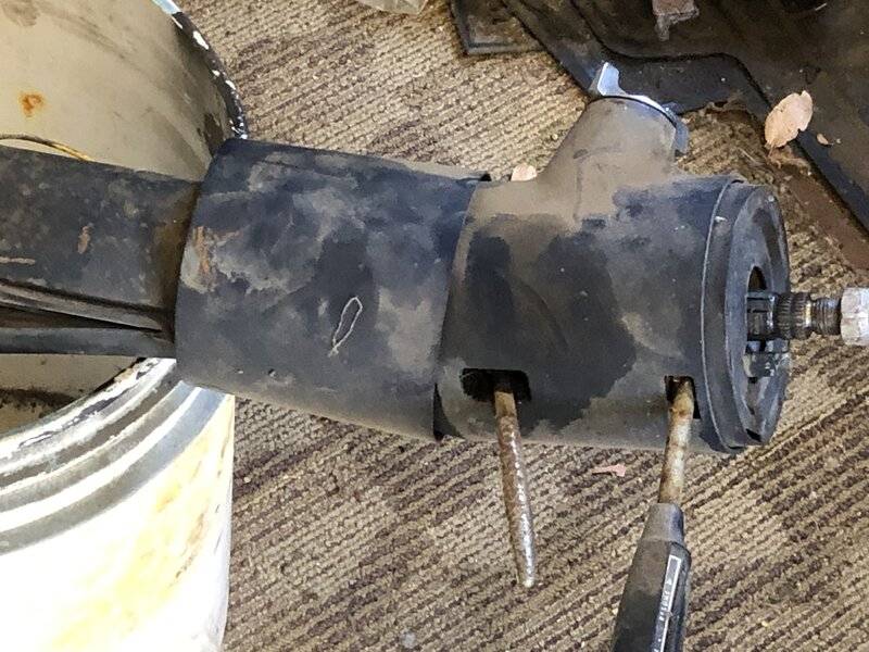

I just had 1 hole pre drilled for the roll pins, i need to remove the steering column again to finish it off.
Not my favorite job...but after that it should be good to go for a road test.

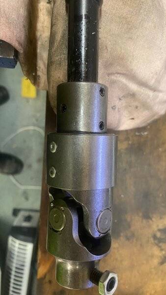

Did you also order the Bergman coupler that mates to the stock steering rack so you don't need to cut the rack and use that U-joint?
I used the optional U-joint, rock solid feel and has a vibration damper rubber inside.
Drilling went easy with the provided drill bit.

I ordered the hybrid coupler for my setup. I wanted to preserve the steering column since I will probably end up putting it in my other Charger when I convert it to floor shift.

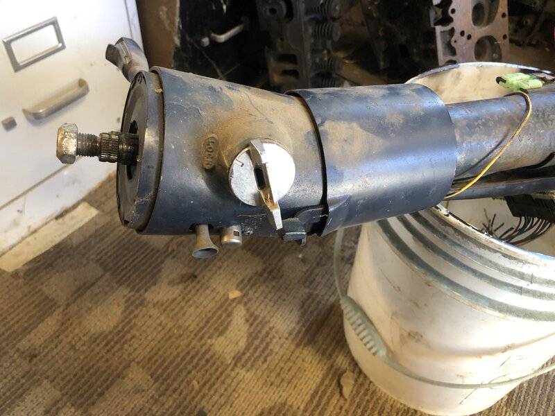

This is a tilt column from a Cordoba.
These were made by Saginaw. They were the main supplier to General Motors for steering related components. Looking this one over, the GM lineage is evident.
There is a traditional Mopar steering coupler at the end and a GM style “Rag Joint” closer to the firewall.
These columns do offer a great range of adjustment.
Not like new cars with air bags where the wheel just moves up or down without actually tilting.

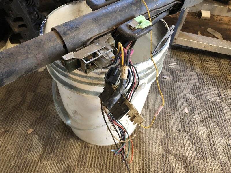

The wiring is a mess but I’ll figure that out.
I did this swap in 2008 in a Duster and everything worked...turn signals, brake lights, flashers but not the horn. I’ll improve on that this time.
The turn signal stalk has provisions for cruise control. I’ll find a plain stalk to replace that.
