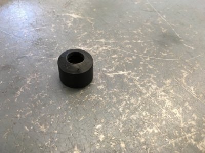

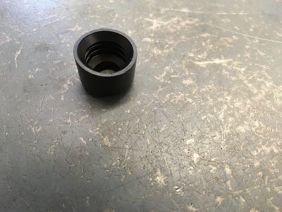

There are positive seals that can be used on stock SB heads, but they aren’t the style of seal that you’d find on newer vehicles.
The application should be something like mid-80’s 318/360’s, might be intake only.... but I’ve used them on both valves.
They’re only going to be a “positive” seal on unmodified/unaltered guide bosses.
