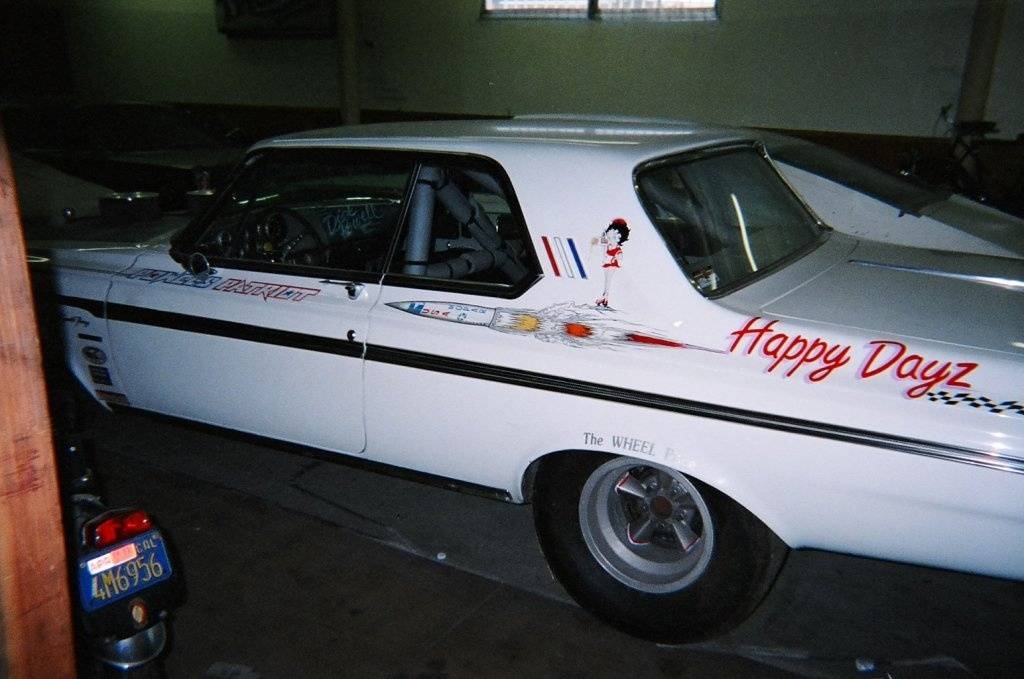

Max Size Drag radial with 15x10 wheel on rear of 70 Coronet body with XHD Springs that has worked ... go
Should be able to fit 315's. I like 275's on 10" rims.
315's will need a 5" backaspace
315 drag radial with what sidewall 50? 60? 65? And ty for the response don't wanna spend $400 and not fit lol
I'm looking at the outlaw 15x10 wheel because Centerline went tits up
I ordered my front wheels already but won't order rears until I have the rearend in and measured
my 63 sf mw ran 315's on my 15x10 americans
