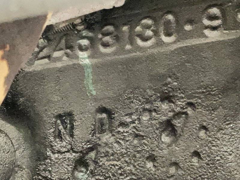

Is this Engine number sufficient to tell if the motor is original to the car?

There is another tab with the last 6 numbers of the VIN number stamped on it. It is just above the oil pan.
