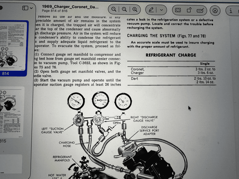

This is a OE system? Or aftermarket? Cause this is a factory service manual for a 69 Charger... And the factory A/C uses a little more than 18 oz or freon.... Yeah, pretty Sure 50-54 is more than 18...... The conversion to R134 means 20% less freon so 40-43 oz of R134....
1 wild rt is correct when converting over you use less freon.
