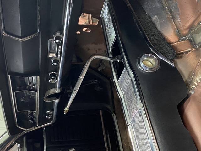

This is in my 67 satellite with the t56
Not sure why my pic is sideways??

Do you have pictures of your custom consul. And the one that has the 67 satellite with the shifter curve like that I have to look and see if mine shifter that curved or not
