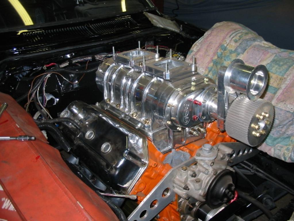

Little boy,remember you always have to agree with POOPAJ [POPS],and ALWAYS laugh at his attempts at making a joke or no more beer and you might have to pay some rent.
But once again,POOPAJ had to be PUSHED to deliver something he said he would do.I will refrain from putting up "THE LINK" to a particular thread on YB.SO,who's blowin' the hot air,and who's suckin???
