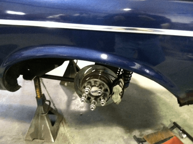

Wilwood has a vented rotor kit that works great on the street and strip. It is what I put on my car.
I have both Wilwood's and Strange on my 4 racecars. Strange blows away Wilwoods in every aspect. Stopping power, ease of installation.
You'll have no problem on the street with Strange brakes and rotors. Use em'.
My 65 Plymouth was street/Strip and I went cruising almost every Saturday and had no problem with my Strange Disc brake setup.
