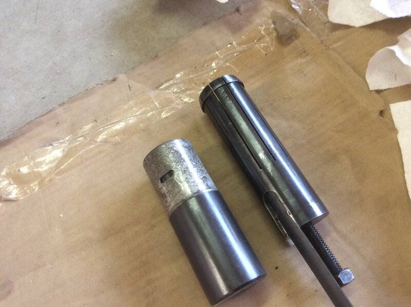

So looks like I need to be looking for one of those in-car bushing remover tools Miller used to make. I think Brewers may have them.
Anyone use one of theirs? OK quality?
Does the tool also work to drive the new bushing in place?

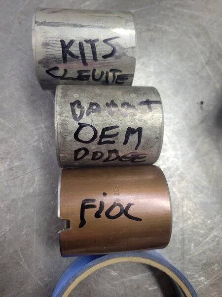

Check e-bay for the tool and yes it includes the driver for the bushing. Good luck getting a bushing that is any tighter. The factory bushing was machined in place, all others will be loose. Feiock performance sells a coated c-6 bushing that is tighter, c-6 and 727 are the same, other than the drainback hole, durabond sells a coated bushing but I do not know if it is tighter as they are backordered.

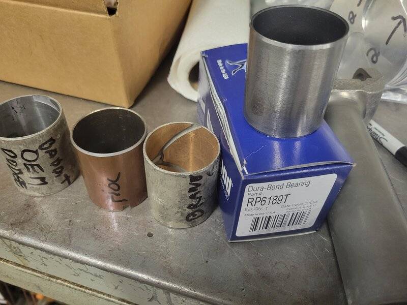

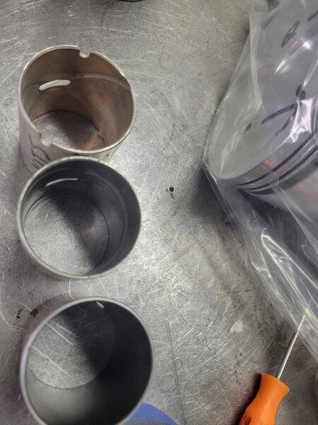

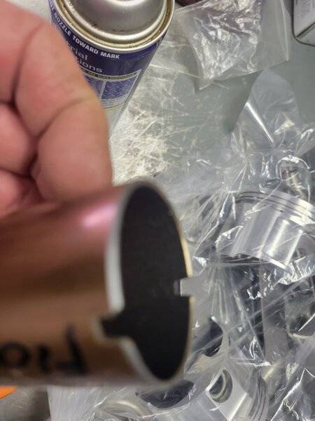

Brewers is fine, new yokes are a little small Pic shows the bushings, the coated one is tighter and am pretty sure once beat in it will get to the .005 clearance, the common brass ones end up at near .010, factory babbitt is about .007 but I can't get them lately, so I have been hard chromium the yokes and using the durabond. Waiting on the durabond bushing, they say mid may or so, hope it is still tighter like the fieock performance, otherwise I will make a drain hole and groove in the feiock and run it. I think when these cars sit a long time, and the trans is not 100% full, the bushing goes dry and when you first drive it gets a scratch or score mark, then it gets worse from there. Jack them up from the front so the bushing gets lube for an hour I guess after long periods of downtime. Anyway that is what little I know, it is a problem

On the tools breaking I have heard the puller threads strip, on any puller threads it is wise to clean them well and lube with gl-5 gear oil or some other high pressure lube, it's a $100 tool not $500 like oem one.
That’s generous Fran. Already sent an order in to Brewers this afternoon. They only wanted $100 for the tool and I figured with the car guys I hang around with it doesn’t hurt for one of us to have one of these. If Brewers blows off my order, I’ll holler back to you though. Never know - I ordered a gauge from Autometer 12 days ago and they took my money and I haven’t heard a word out of them yet!

Here is the durabond, one piece tubing, no seam like the others, coated, no drainback hole, measures the same as the fieock coated bushing.
