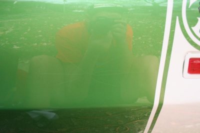

Ive got a similar one, gotten progressively worse so get after it. Also have some at rear window corners, on rear quarter on top at the ridge and this one showed up the other day and I am TOTALLY Disgusted. My body guy said it was due to poor prep and the underlayment is separating which allows vibrations to crack the paint layer. I dont think there is a crappy fill job cause this one is on a piece where partial was put in, you can see it from the trunk. Anyway I'm sick about it. He's telling me the best fix is to take the car back to metal and repaint the whole things since it is appearing in various spots. One thing i did notice is there are no places forward of the door jam where this is happening. Any other opinions? dont mean to hijack just bummed like you :hmh: IMG_9124.JPG.jpg

I found the other thread you had on this topic. One thing that was interesting was the mention of flexing causing these cracks. Coincidentally, my car was jacked up on one side to investigate a leaky fuel tank. Do you guys think that could have caused the flexing and ultimate cracking in the lower quarter panel shot I posted above?I discovered this crack soon after the car was jacked up.
Yeowch! Sorry to see it. If you have it happening in other areas, sounds like there was some bad prep all about the car. Your body guy sounds like he's on the right path. I'm sure it will be showing it's ugly face in more areas soon enough, especially since you have cracking in an open area/low stress area of the panel. As far as cracking because of jacking it up on the other side, hard to say. I would think no, but if there's a really poor bond underneath I guess the pressure from the weight pushing up from the extension panel and outer wheelhouse might have been enough to make it give. Best of luck moving forward.
