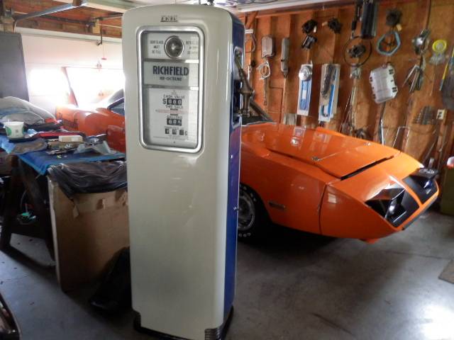

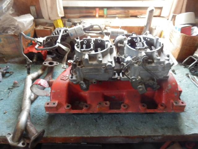

About 40 mi from me,only thing beside rust removed is seam sealer.Once done,as long as not in humid condition,can sit as long as 60 days or longer,then only needs soap and water wash before regular paint preparation,I had this old pump and this Hemi intake dipped,both looked as new metal when they came out of tank.I will never have anything blasted again as long as I have this process.
http://www.mecchemicals.com/
