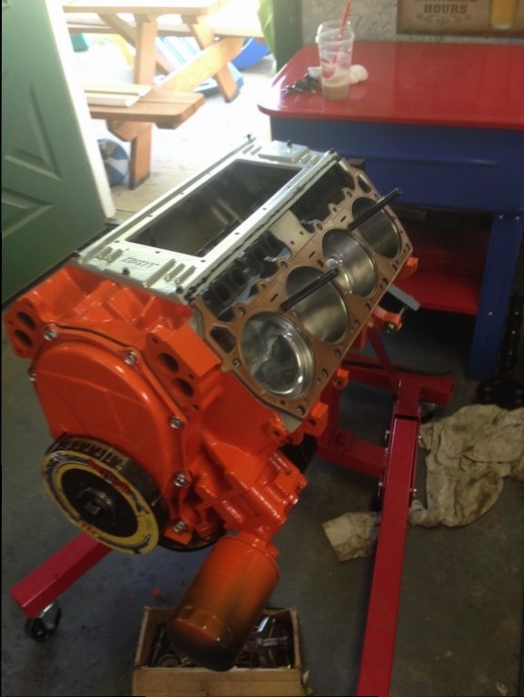

If you shop around and be patient, you can get parts for as little as: 440 crank and rods-$150, 400 motor-$300, New pistons and rings-$650, cam and lifters-$300, Timing chain set-$70, gasket set-$100 or less, bearings-$150. that comes to $1720. Then you have to turn down the crank, and may have to have the counterweights cut down .250"-$300. Then my block bore/hone, re size rods, install cam bearings and freeze plugs, new oil pump drive bushing, balancing came to $980. So you're at $2700. Oil pump $75, so $2775. That's just the bottom end, and I could have forgot something. So plan on $3000 minimum for a good bottom end. Then heads: you can do a basic valve job on the 400 engine heads, $300 to $500, (They are Prob 452s). Or you can spend $1500 to $3000 on aluminum heads. But be prepared to spend some money for some quality heads/or head work. That's where you can see some big power gains. So now you're at around $4500 to $6000, depending on your choices. So there is no simple answer here. Every build is different. Plus you have an intake to buy, carb and headers. I used the stock valve train. My 400 came with a Street Dominator, which worked great! I had about $4500 in my 451, and it put my RR in the mid 12s in the 1/4 mile. Great running combo, those 451s! Good Luck!
