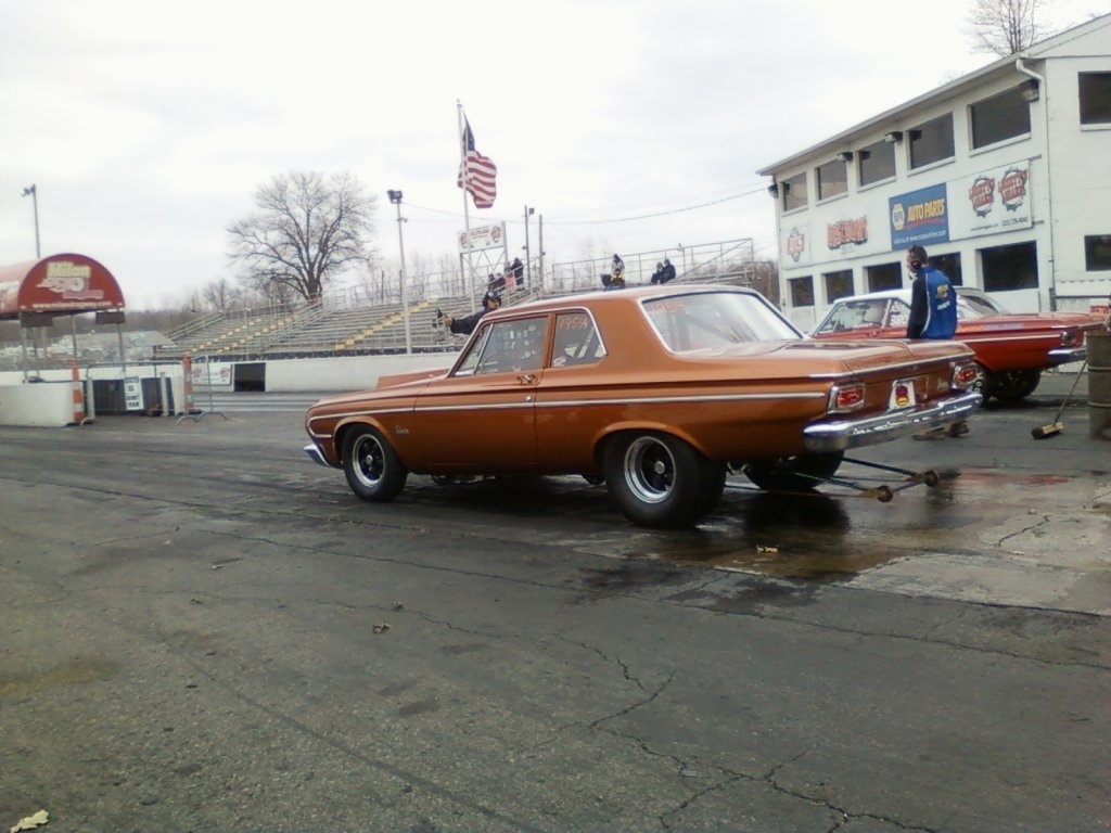

Depends on what you need. The block with the best sonic numbers is number one. After that I'd take a good sonic 400 over a good sonic 440. My curent engine is a Mopar Mega block 572. Never dynoed but calculates around 900hp. Been 9.02@149, 3345lbs.

That's far more realistic. I can tell you getting to 900 is tough for the average builder. I build my own. Not many 9.0 N/A B Bodys with factory floor pans and sheet metal.

572 Mopar megablock,15-1, 285/292 on 112 lca .800", ported -1 Indy, Jessel belt, T&D 1.7 paired rockers, 7/16 Trend pushrods, Isky red zones bushed lifters, GZ vacuum pump. And now the real speed secret. Indy box ram with 2 nearly box stock Eddy 750's. On a side note: Canyon 707 did your new motor come from Al A?
