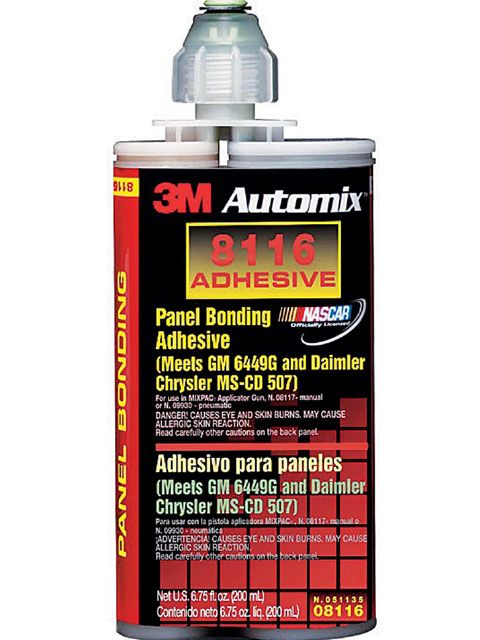

I am no bodyman, but I have used the 3m 8116 for my 68 charger grill restoration. I found that it bonds plastic very well. I had several little "fins" in the grill that I had to put back and some that I had to recreate buy cutting them out of old grill parts. I fixed cracks with it and filled spots with it in the plastic.
It's very strong. I wish it set up a bit faster, but that's what I get for using it on something for which it was likely not intended. :HappyNewYear:
Lord Fusor has a structural bonding adhesive that is amazing for stuff like that, it is clear and sets up in 90 seconds at room temp. Product #141. A word of caution...expensive stuff these adhesives...you must know the plastic that you are working with. Olefin vs. non olefin based plastics. In simpler terms...ABS, PVC, PUR, PC, TPUR, are a few that once cleaned will bond well with many adhesives out there, but beware of olefin based plastics such as PP,TPO,TEO,TEU, as an example. These guys need an adhesion promoter and special prep in some cases. A simple rule when identifying which is which for plastics is to carve a small piece of the plastic of the part to be repaired and throw it in some water. break the surface tension on the water by submerging the plastic, if it floats it needs an adhesion promoter, if it sinks it doesn't. Another plastic that cannot be repaired with any adhesive is PE, or polyethylene, it will float as it is an olefin but no adhesive on the planet will adhere long term. You can identify plastics by there ISO code found embedded in the part during manufacturing. Washer bottles and overflow tanks are generally made of PE and can only be welded if a repair is needed.
The adhesives are fantastic and should be purchased by application, read the mfg's directions carefully and cleanliness is crucial. Rubber gloves are mandatory to prevent contamination of the bonded area and your bloodstream!
