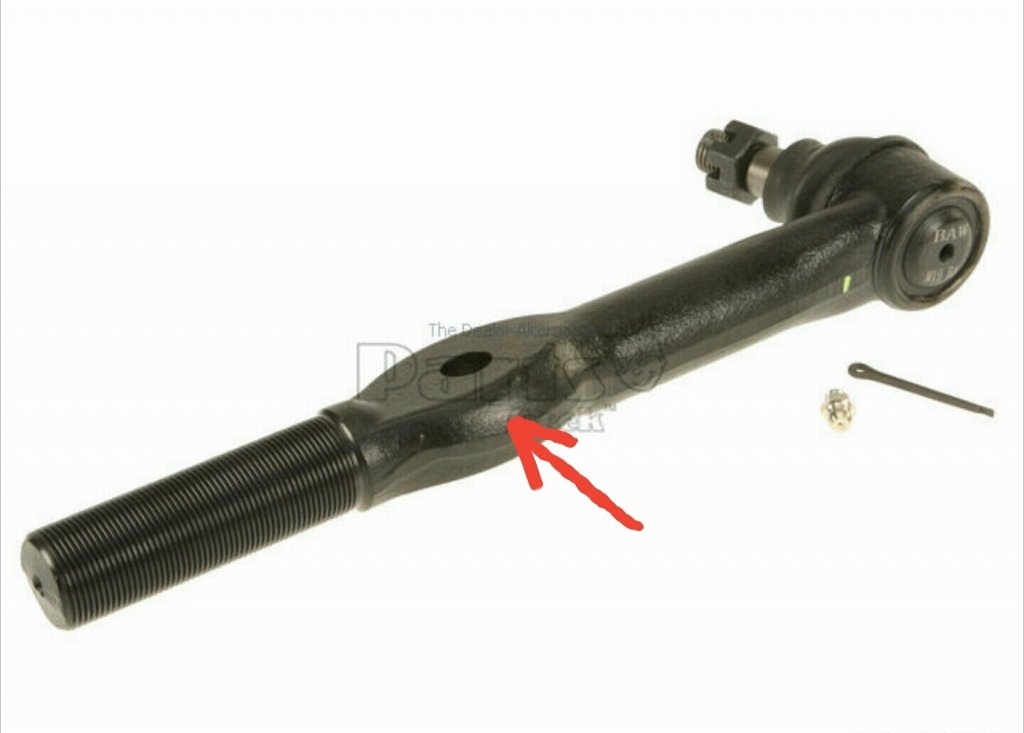

Persistence with the hammer blows usually works. Pickle fork, but you'll need a new seal, which might be hard to find. Sometimes holding another hammer or something on the opposite side while smacking the drag link with the hammer.
Smack it on the side with a good size hammer!
