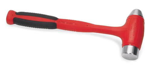

Dead blow? My dead blow hammer is not metallic. Is there such a thing?
Yes, sir. They are not cheap, but Snap-on makes them in an asst. of sizes.
