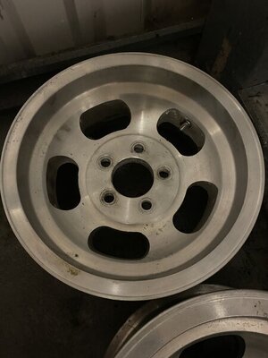

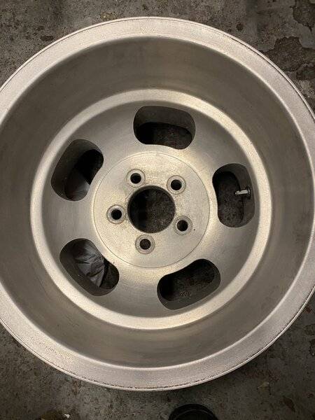

i have a 68 charger RT 11” drums, just picked up these ansen sprint mag slots
15x10
14x7
My studs need relacing and i would like to find some era correct lug nuts and keep it all safe
ebay is a mine field, please help
Thanks
229A38F8-65F1-4B77-9035-B8E671E09A05.jpeg 5571D4A0-CD8F-44A9-B8A6-CDA26F816BF8.jpeg
Anyone know where i can get some lugs? Is there a part no? Thanks
those wheels will use the round washer , as far as lug nuts you will have to measure how thick the wheel is at the lug hole and the hole dia.
you will want the shank of the lug nut to contact as many threads as possible without bottoming out on the drum or stud base.
Old aluminum mags are cool, but pretty much each style and brand will use a different nut and washer combo.
the link sloinker posted is a good place to deal with. have some measurements handy when you contact them.
Thank you 1967coronet I appreciate your help guys
