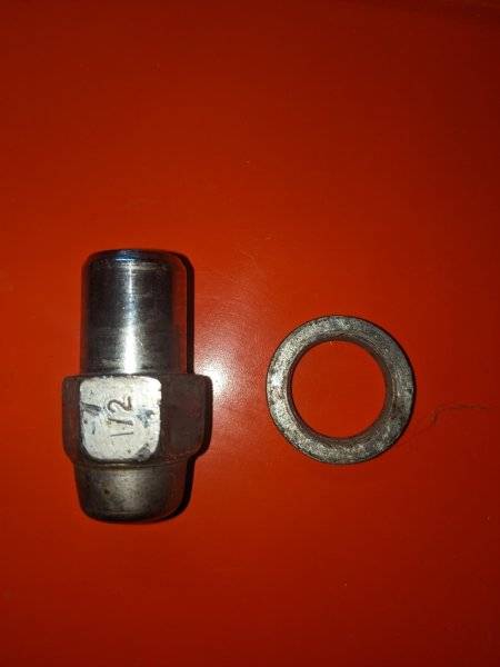

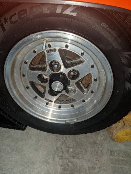

I just picked up a 68 Charger with reverse thread studs on the drivers side. The car came with these American racing wheels that I would like to clean up and keep for now. Would anyone have these style 1/2 inch reverse thread lug nuts or know where I might find them. I need at least 5. Thanks, Rick
Change the studs to right hand, that's what I did.

Readily available on Ebay. You need to measure the length of the shank to get correct shank nuts. Here's some with 3/4" long shank:
