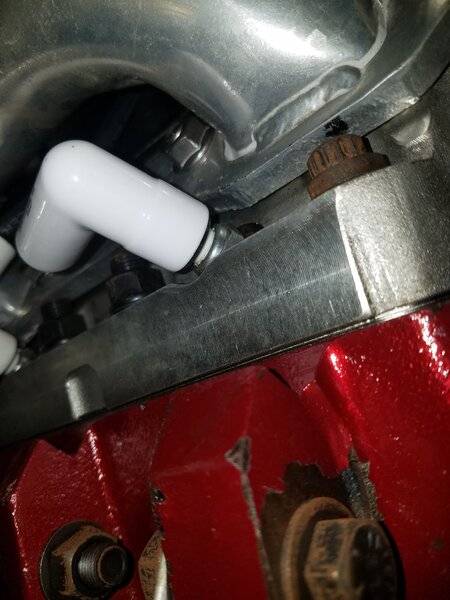

Love those ceramic ended spark plug wires. Gotta get me some.
They are pretty neat, these have a nuisance about them though that I find some What annoying. So the boot is ceramic and there is a positive click when you seat it on the plug, but unlike a typical silcone/rubber boot they spin on the plug very easily...if you bump a wire, it will spin...which leads me to check again and again that it's fully engaged in the plug...I can't help myself and have to go back through and check every single one again every time I see one rotated....
