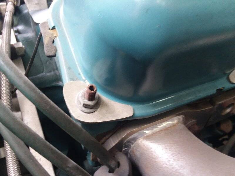

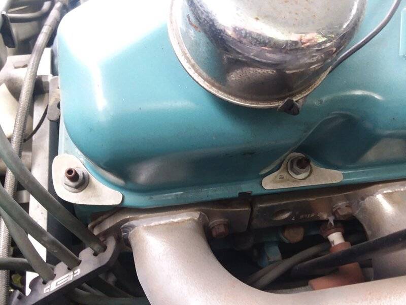

Yep, I worked through this very issue when installing a set of factory valve covers (and my friend here was very
helpful in it!), as shown in this thread:
https://www.forbbodiesonly.com/mopa...l-valve-covers-studs-instead-of-bolts.157179/
In a nutshell, this is what I wound up using:

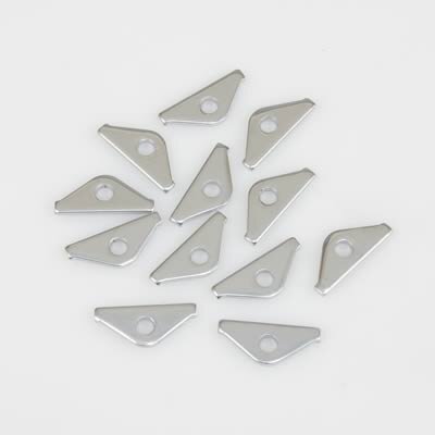

Mopar 4349620 valve cover "spreader" washers.

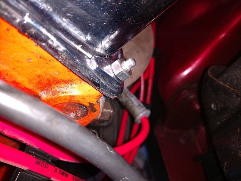

If i remember right, these are either 1" or 1 1/4, i think the longer, used with moroso gold covers painted turquoise. They are long enough for my cast covers too, but that entirely depends on the design of your cast covers, and how tall the bolt holes in the covers are.
