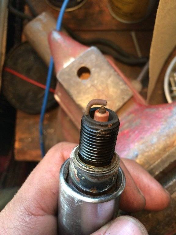

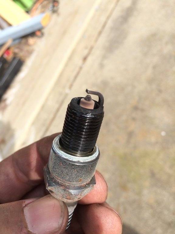

these are my plugs from a month ago
This was the old carb. Looks like slightly too much advance, not a hot enough plug? Am i reading these right?
View attachment 424740 View attachment 424741
Yeah I don't see any color change on the strap which means it's cold. Find out what Mopar recommends and buy that specific manufacturer and model spark plug...it should get you close.
